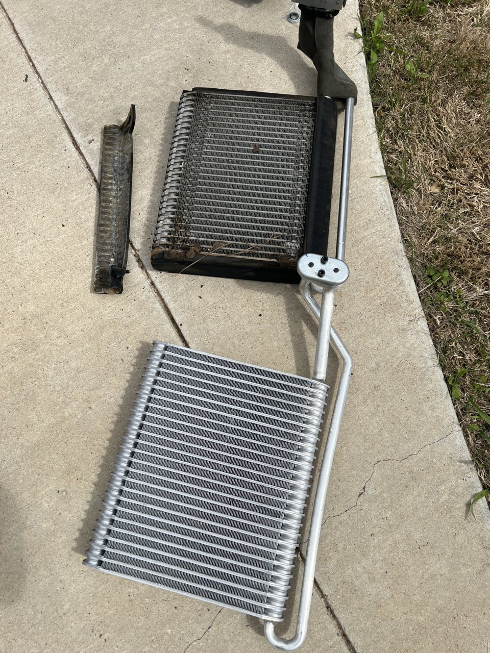

    Do you try and reuse the foam insulation?

    They typically come with new foam.

    Is that an OEM Heater Core?
    If so it should have the foam on it already.

    It’s an aftermarket evaporator core

    That's the evaporator but yea it should have foam on it or come with new foam strips.

    I ended up buying an OEM evaporator core. Came with all foam pieces and fit perfect. The price wasn’t much more than aftermarket.
    When I was buying a bunch of parts I assumed OEM would be ridiculously expensive, but it was only $90.

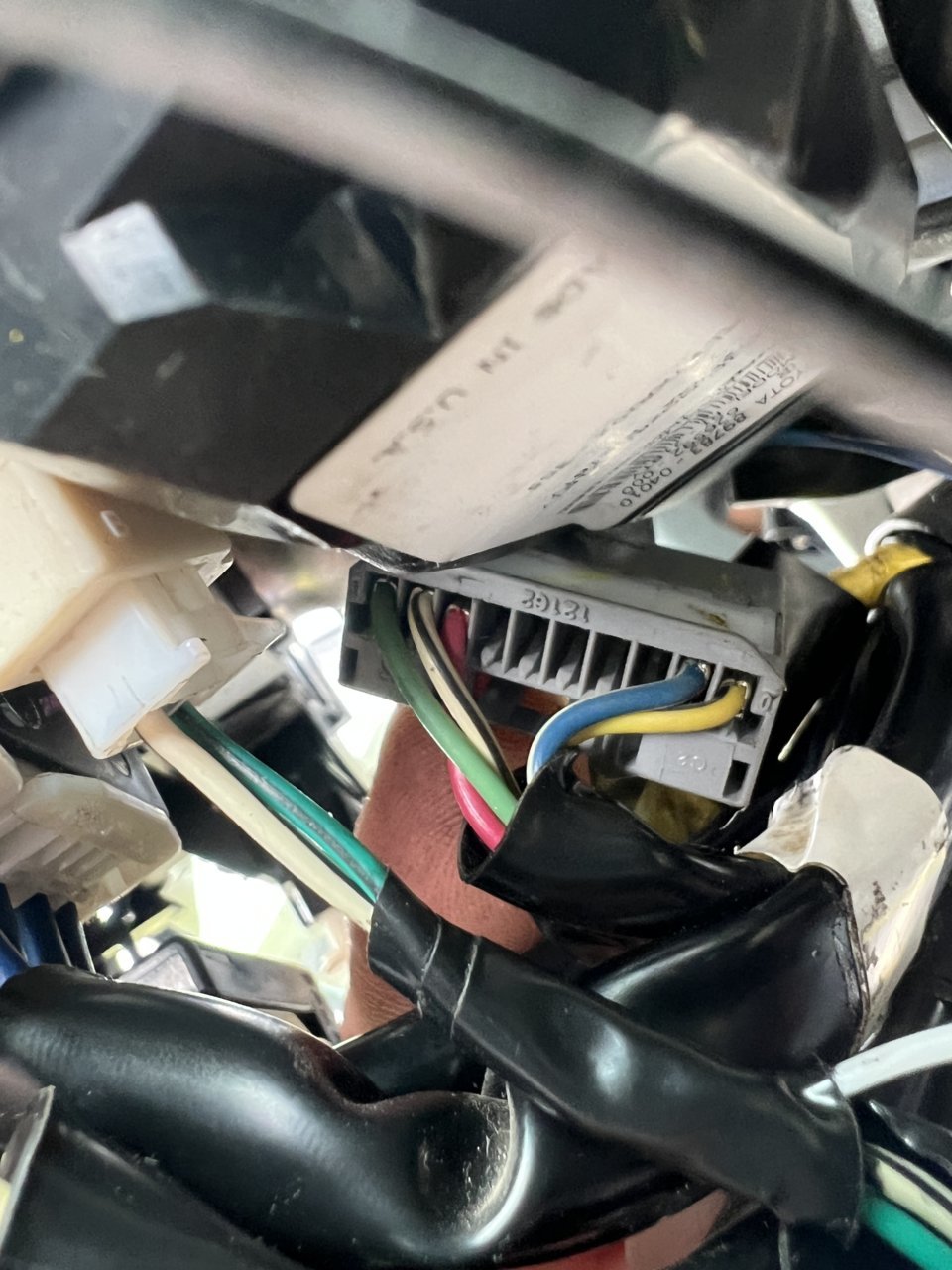

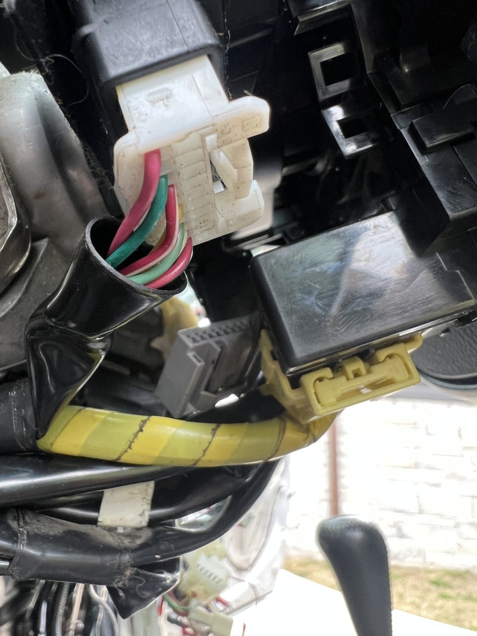

    Going back together now and can’t find a plug for the grey connector under the steering wheel.
    Is this unused?

    It may be, what color wires are going to it and what year is your truck?

    It’s a 2007
    Here’s a pic

    That is the Steering Angle Sensor connector, it's not used on that year unless you have Stability/Traction Control.
    The Steering Angle Sensor would be attached to the back of the Clockspring if it was present.

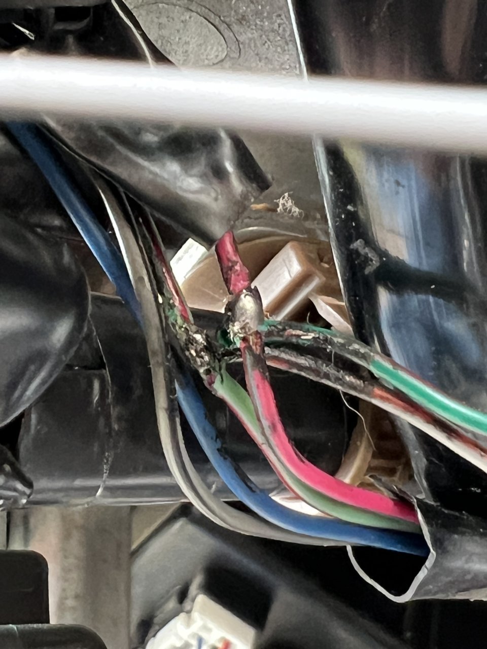

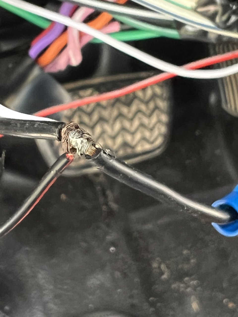

    I’d really like to get rid of this aftermarket alarm, but am worried that I’ll miss something and cause a no-start issue.
    Is it as easy as finding the alarm “brain” and disconnecting the spider web of wiring?

    Yea just remove any wires that were tapped in, repair the spots in the factory wiring insulation, reconnect any factory wiring that was cut, and throw the alarm/remote start rat nest in the trash.
    Most are just tapped into a few wires but some are deeply rooted and can take some time to remove.
