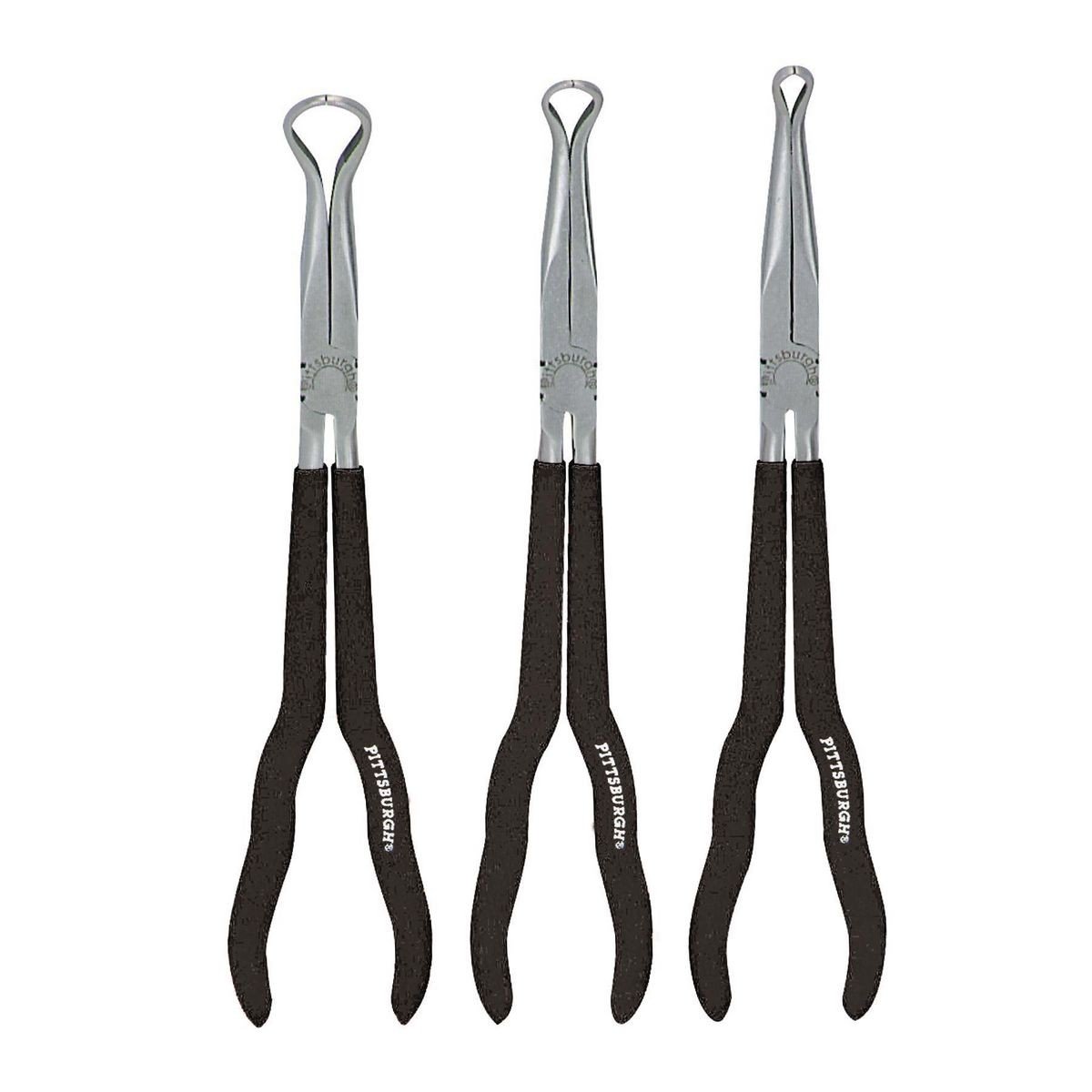

    I bought these cheapos at harbor freight. They work pretty good including my heater hoses.
