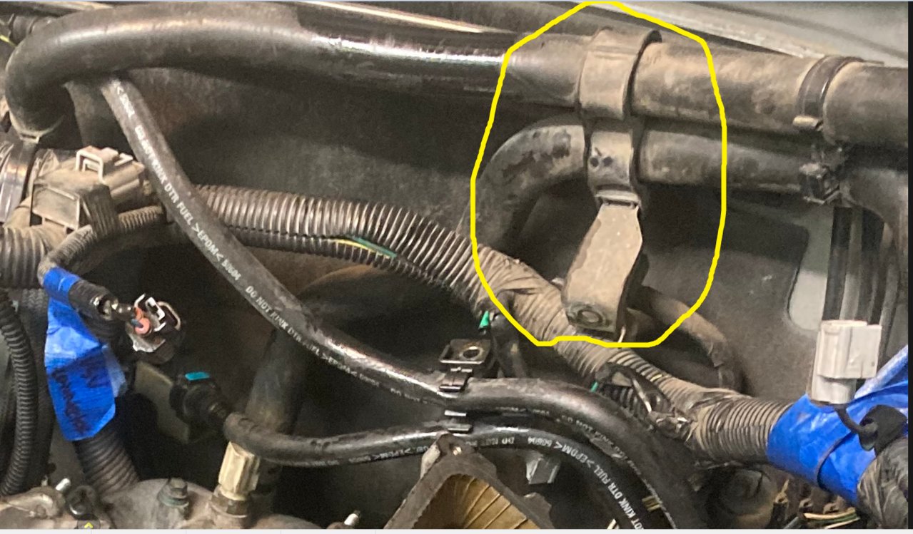

    Any ideas on part no.?

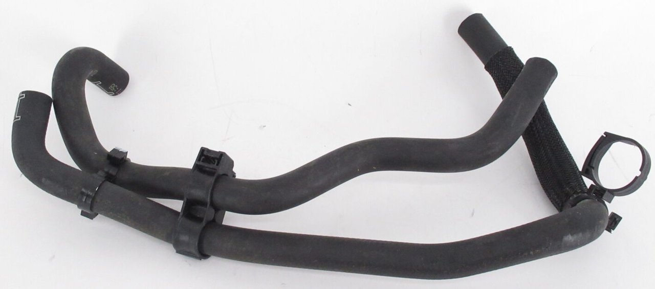

    I don't know the answer, but I recently did the heater hoses on a 4 cylinder, and the divider clip comes with the OE Toyota hoses. So, it may not be available separately.

    Looks to be the same deal on the 4.0 V6 where the butterfly clamp is part of the hose assembly (P/N 87209-04020).

    I was always wondering about how to replace that part. I never did and put some tape on it. I guess I’ll be keeping the tape because I’m not gonna be spending $100+ just to get a clip lol.
