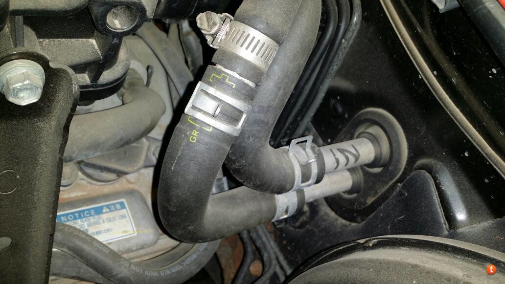

    x2 I tapped into the lower hose to avoid interfering with heater. There is already a factory splice there. I left the short hose in. This way if I ever have a rupture in the exchanger, or hoses, I can very easily bypass the shower setup and go back to stock in the field.
    I cant remember what size the hoses and fittings were, but I believe they were 5/8. Don't quote me on that though.
    I've used it probably 12 times now. I definitely need to raise the idle to 1050 or 1100 to really get a "home like" temp. if I just idle, its warm, but not hot. At 1050 ita glorious!

    Is there any way you could take a pic further back to show just where that is in the engine bay?
    And what's the advantage / dis
    To going before or after the stock heater core? Was it just the existing splice that made you do it?

    Driver side firewall between the brake booster and the engine.

    Either way will work, but if you connect on the input, the hot coolant from the engine will first pass through the heat exchanger before entering the heater core, potentially at a cooler temperature, thus affecting your heaters output.
