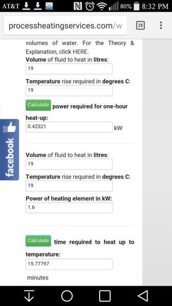

    @2ski4life
    It's in metric but here's roughly what you're shooting for with this system-
    Let's assume the coldest you can stand showering at is 40 degrees Fahrenheit (my engine powered has gotten me through several 30 degree trips)
    Meaning your water cans will start off at 40 degrees. A comfortable shower is near 105 degrees, so you've got to bring that water up 65 degrees.
    The propane heater and the engine powered type will reach that in under 15 minutes, so we will use 15 minutes for the time required to heat your water up
    ( who likes waiting for a shower anyways?)
    We will also assume you and your lady (man?) will be needing to bathe, so let's use a 5 gallon volume to get that done.
    SO.
    5 gallons of water raised from 40 degrees to 105 degrees in 15 minutes brings us to a grand total of 1600 Watts of energy required to get that done.
    Conservative factors:
    I completely ignored the heat loss from the heater element to the water that will actually hit you out the nozzle, ignored any efficiency loss, and ignored any and all voltage drop from your truck and water pump running, so we will leave your volts at 12, time at 15 and your gallons at 5 for a fairly accurate real world calculation.
    TL;DR:
    Your idea would require an amp draw of 133.33. Even with the tow package from the factory you won't have enough power out of the alternator to perform this. Not to mention building a 1600 watt dc heating tank will cost you FAR more than using your heater core or buying my damned propane heater.
    There is simply no replacement for the energy you can burn out of hydrocarbons.

    ? Huh?

    Haha oh oh.
    I really wish it would work but physics makes things difficult as usual..

    Lol thanks for the calculations Spencer. I guess Ill start working on my heater core project.
