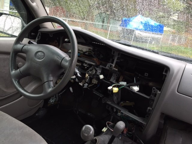

    Found a few drops of ante-freeze on my passenger floor mat. Looks like I'll be doing a heater core. Anyone have any tips???

    Sadly yes! It's orange... Owned the truck for about 6 months and nothing but this morning found a few drops on the pass floor mat. looks like it's dripping from the heater box above.

    Got it mostly apart but the dash cover is being stubborn on the passenger side. Is the airbag supposed to come with it or stay behind?

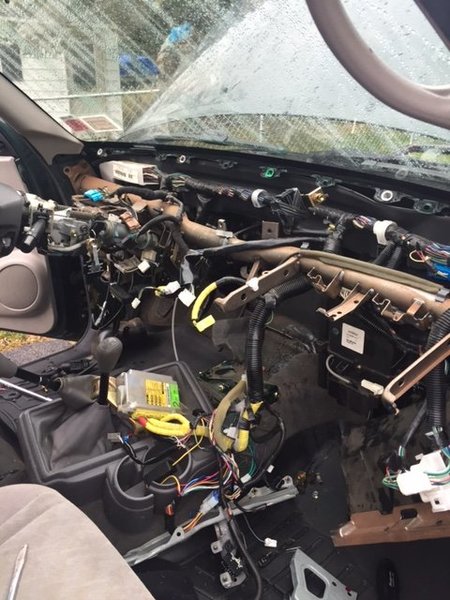

    Got it done today!!! Was able to get it out on the drivers side. Didn't have to remove the A/C evaporator box. What a PITA!!!

    Jesus christ.

    Looks about as bad as doing the heater core on a Volvo 240. Jeez I really hope mine never goes. Nice job getting it done
