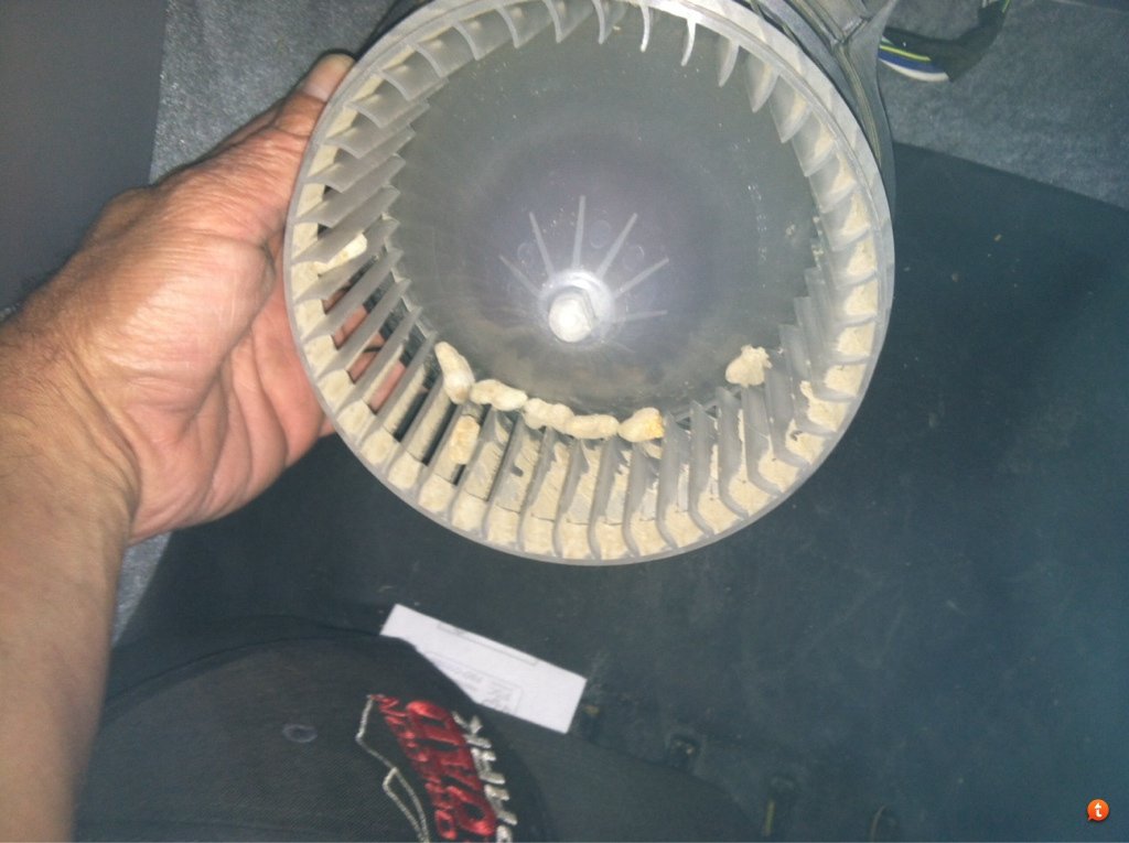

    Just got my 09, and turned on the AC for the first time - nasty vibration. Jumped on the site, did a search and the pulled the cabin filter - it was dirty. Fan looked clean, but pulled it anyway as its only 3 screws:
    Kibbles stuck in the blades. Quick bit of clean up and it runs smoooth now.
    Not sure how the little bazterd got in there, but some rodent sure did. Problem solved.
