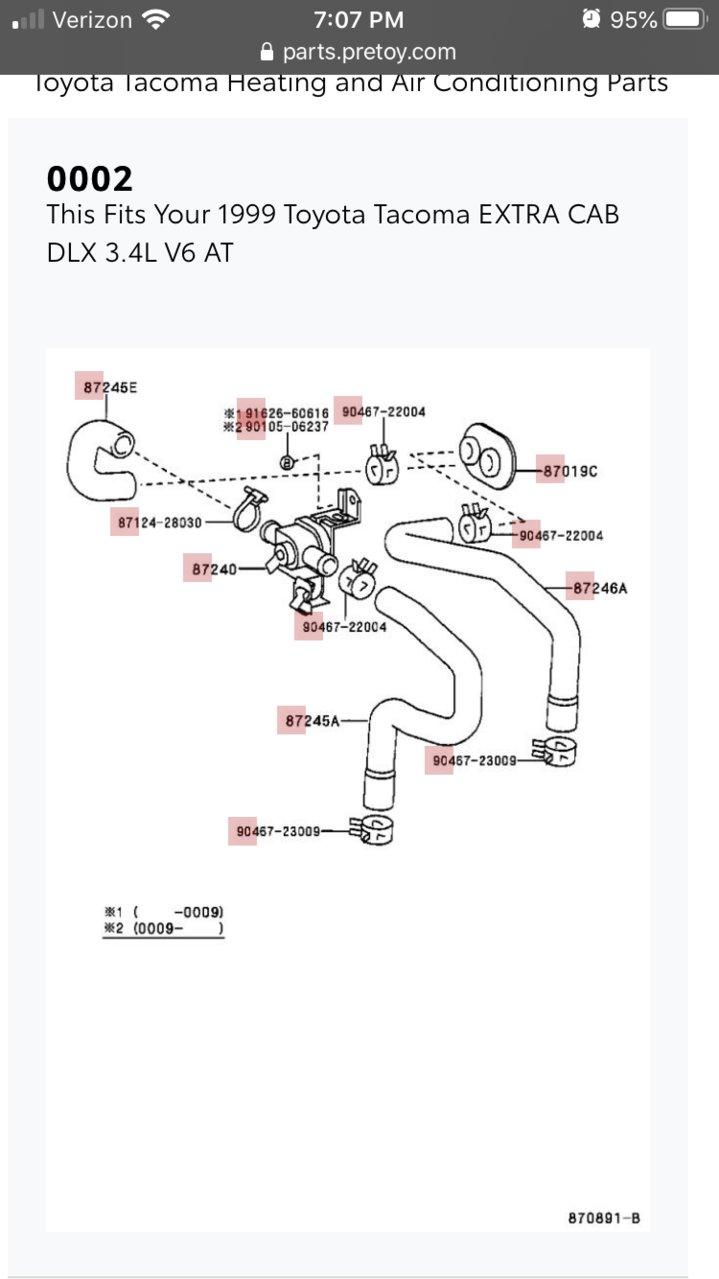

    Recently had a major service of on my 99 Prerunner at 245k miles including timing belt, all the engine internals involved that is recommended such as crank, cam seals, drive belts, Pullys etc. from Toyota dealer.
    Also had all 9 coolant hoses replaced and I supplied all OEM ones with matching NEW constant tension clamps and organized all hoses+clamps for Tech to replace.
    Got truck back and they gave me two of my new clamps back along with all my old parts/hoses/clamps and two old heater hoses were also missing two Old clamps. Due to this it leaves me to believe they reused two clamps as I supplied the correct amount of clamps+hoses. I also found two old Looking ones At the bottom of the two heater hoses that go into the rear of the block That are now on the truck and suspected these were the two re-used and stated this to my advisor
    Advisor says tech insists not the same size clamps/part as the clamps on the top part of the hose Going to the firewall. Tech stated he used two that he had lying around instead that were correct size.
    I call BS! and insisted they replace them with new looking ones like I supplied as I don’t want to have issues with leaking down the road from them lying to me as I have had leaks before from Re Using old clamps on my other vehicle.
    They insist that they have to order the Two clamps and mine won’t work. Hoses are all the same exact diameter when I held them all up together so can’t see the clamps going to the block being different size!??
    It’s been two weeks and STILL waiting on them to get the clamps that now supposedly are on back order...
    the attached picture does show different part # for bottom clamps as opposed to top but this doesn’t make sense to me And I can’t find that part number to order or see if they are infact No longer available.
    Note *
    All this and not to mention I had to have the truck towed back due to a hose leak at the firewall After the job was done Initially. They had to double up clamps and move The heater hose back more on the heater core pipe to get it to not Leak due to too much corrosion. they tried sanding some of the pipe down to clean it prior so this might have played an affect as well due to damage. Not an issue now as it’s fixed but just hiccups and I am understanding.
    They also used Toyota Super long life pink coolant where manual states red and red is what I have always run in the truck. They insisted they used red but I can clearly see pink from the leak and paper work says the pink super long life coolant so my faith in Their honesty is being tested now. So insisted changing to the red Coolant as it should be while replacing the old looking clamps with new ones. AND I even said I’ll pay that extra charge.
    Many say red and pink don’t mix but believe it was cleared up that they do but I want to keep things the same on an old engine to play it safe.
    All this leads me to be very untrusting due to their lies so far and me having to call them out on it. Little things but still, be real and upfront with me.
    * My question *
    Are the heater hose constant tension clamps ALL the same at the top and bottom of all 3 heater hoses On the 5VZFE Engine?

    Your diagram shows at least 3 part numbers at play. I think two of the part numbers got merged. I just did some of this on my truck but will have to go back and look to see if the clamps are the same. I do remember ordering two types and got only one, but I may be thinking of the IACV hoses

    i know the top left hose clamp is a different part# and even different looking clamp clearly in the pic. I actually didn’t get that one but used the ones like the others because the other styles were what were on my truck Originally. Dealer installed it and it’s just fine no leaks.
    But yeah the bottom two going to the block are also different numbers but I can’t see why or the fact that they would actually be different and a different size.

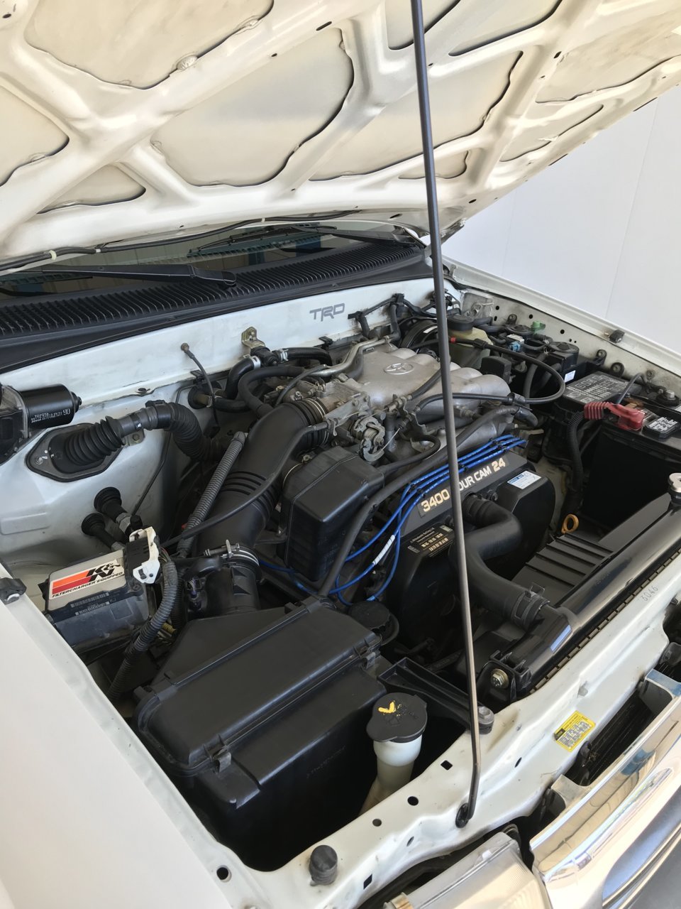

    I have tipped a tech heavily personally on a job done right in the past as I am appreciative as I am a perfectionist myself.
    here Is my engine as an example of how I keep things
    BUT don’t lie to me and play me for a fool because you forgot to put the supplied parts in the vehicle that I have kindly enough organized, sorted, and supplied.

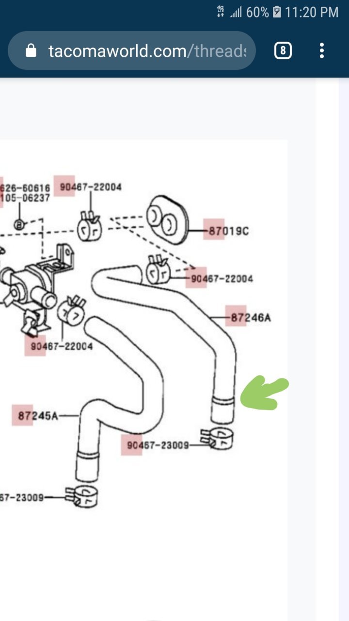

    Those upper and lower clamps are different, look at the part numbers.
    This little rib on the hose, along with the different clamp means that the hose diameter is different at the bottom

    So based on that pic and what I found online, yes the numbers appear to be different
    I know holding the hoses up together when I had them new before installed, that bottom end had the same exact diameter as the top Öhlins them up together. The new clamps that I bought also slid over both sides the same leading me to believe how different could the clamp actually be? Very weird
    I hope to find out soon if the shop is infact able to get this different part number clamp and I can see the old ones and compare to see if infact they are different.

    The hose might be close to the same size at both ends but if the diameter of the metal pipe is different then the clamp wont work. If you were the guy responsible for putting the hose on you'd know pretty quick what fits and what doesn't. Sliding clamps around on an uninstalled hose doesnt make you an expert on clamp fitment.
    They didn't "forget" anything, your supplied clamps didn't fit, so they used the old ones
