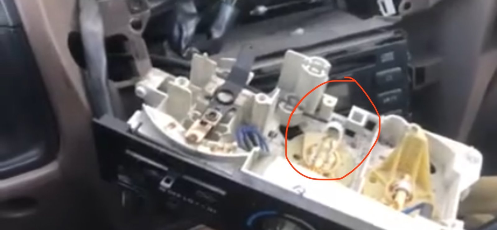

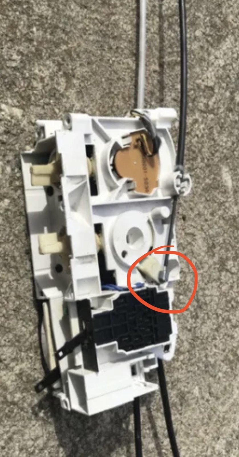

    Ok we may be on to something. The control knob that controls the temp is actually broke and is not turning that valve. I took the cover off and saw where the wire in the photo attached, but the gears are stripped. If i extend and retract the wire it is opening and closing a door but nothing is working the valve. Im going try and manually see if I can move the lever on the firewall in first photo and see if heater will work.

    Im looking at buying a new control center from toyota. By chance anybody have any experience on changing this out? Those cables are sometimes hard to manipulate to even hook up. It looks like several cables also.

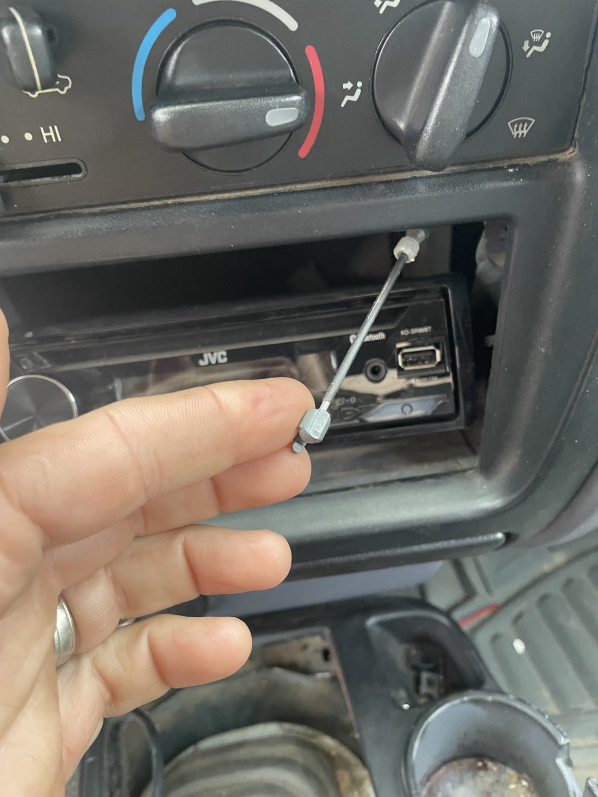

    Is the cable in your hand from the top location or bottom location of that temperature control dial?
    I looked up what I think is the same climate control module you have and it looks like one cable could correspond to opening the hvac door and the other to the heater valve. Looks like you could be handling the lower.
    Photos I think are a ‘98.
    Did you see the other cable when you were seeing that the gears were stripped? That top cable could be your valve cable.

    Beaverdamoand, Im almost positive you are correct. I’m going pull it again and try to fix those stripped gears. More than likely its probably from the cable freezing up and then the base that holds the top gear broke. Its worth a try to see if I can zip tie that base down. To help tacoma owners in the future the control panel part number is 55910-35121 and the cable from control panel to heater valve is 55907-35040.

    Ok guys, I unhooked the cable off the heater valve on the firewall and moved it opposite of what it was. This allowed me to get heat in the cab. I do appreciate all the help. I have to adjust valves and do a power steering flush before I tackle the heater/ac exchange.
