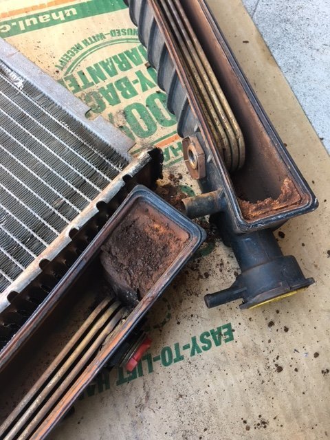

    When's the last time you flushed your cooling system? Old coolant and air pockets will prevent your cooling system from functioning optimally. I'd start there first as cabin filter will have little to do, if any with the cooling system. Yes, a dirty or clogged filter will partially block air inside the cabin but that's about it.
    This might be what your radiator looks like if not flushed and maintained. After replacing it and flushing the system, the heat was actually hot and not just warm.
