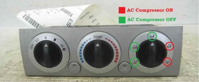

  13. Jan 15, 2020 at 2:24 AM
    #33
    Jimmyh
    Jimmyh Well-Known Member
    May 16, 2012
    #78991
    14,269
    SC
    2012 Prerunner SR5
    This image is correct at least for my 2012 Tacoma. I just came in from checking it. With the AC off and when you shift to any defrost mode ( circled in red ) the AC Compressor does turn on. The A/C LED doesn't light, but the clutch is engaged and the compressor is running and turns on and off with the evaporator temperature.
    Just as described by CurtB/Muddinfun. Maybe try it and not focus on the little A/C led, but pop the hood open and look at what the compressor clutch is really doing. You may be surprised.

    This morning I checked the defrost function on my 2010. I can confirm the compressor does indeed activate.

    I could have sworn the manual said that the AC came on automatically whenever the defrost function was on but when I looked I couldn't find anything stating that. Regardless, I checked and I can confirm that on my 2005 the compressor does come on when in defrost mode. Just like everyone else's.
