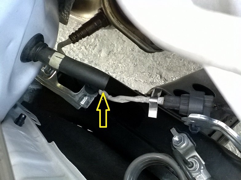

    Drain tube is relatively easy to find (passenger side engine compartment looking down the firewall) I noticed mine wasn't draining well last summer and just used my compressor to blow some air through it and it started draining like a champ again.
