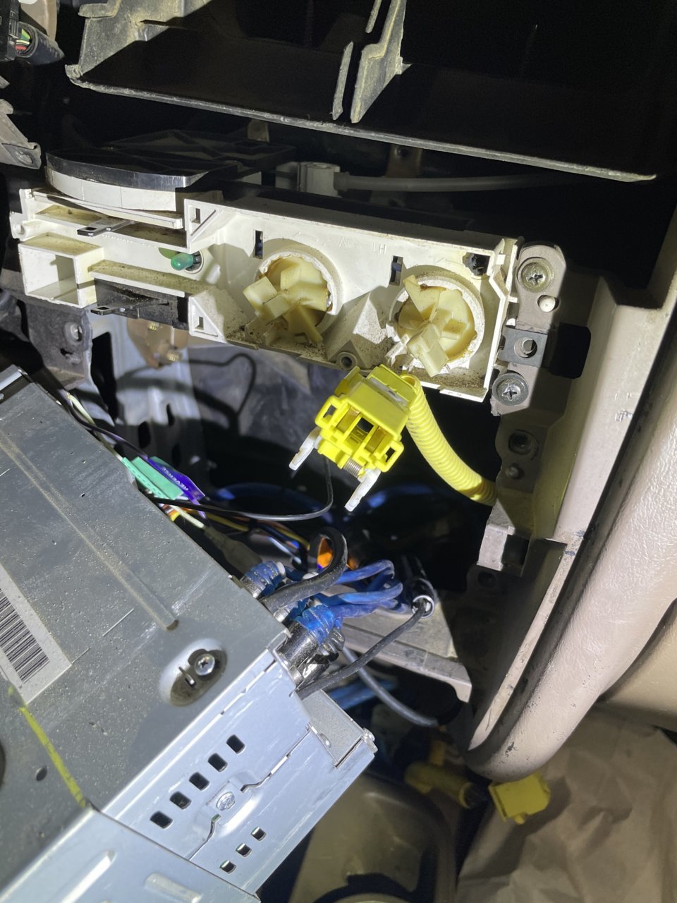

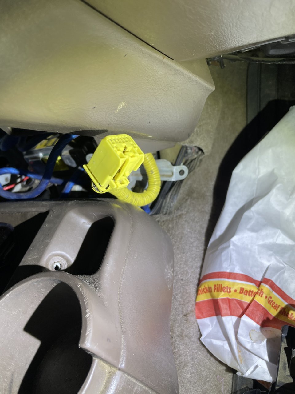

    E2D2AE99-C6EB-4065-A6A6-C7FD855B8B64.jpg Checked the multifunction switch. Replaced with new and no luck there. There is lots of wiring problems with this truck the farther I get into it..637DB5DE-BE42-44C8-9622-3CF0B1E2C14F.jpg

    Still have been unable to solve the problem.. not sure what the next steps could be. Bad computer?

    I'm sure you've already checked all of your fuses. The only thing that comes to mind are the wires short circuiting with each other somewhere where they make contact
