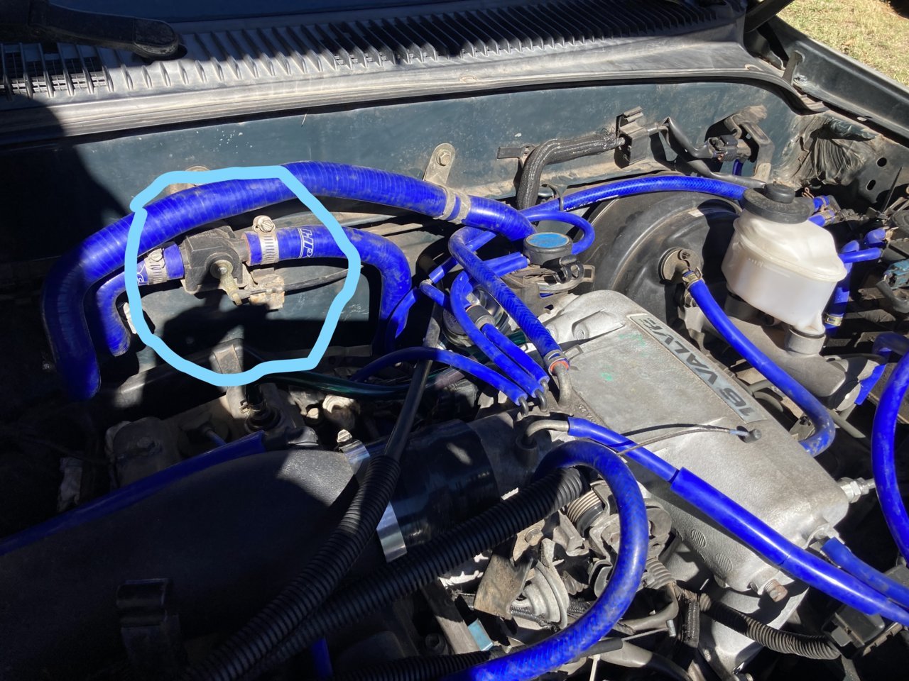

    This is easy one.....
    there is a water valve on your firewall that controls/shuts off the hot water going through the heater coil.....
    Its made of plastic that can get crispy with age....or in a lot of cases the control cable has just slipped out right there in front of it....

    yeah its tht
