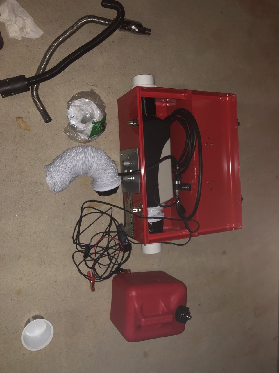

    I bought a diesel heater (as mentioned previously
    https://www.amazon.com/dp/B07GRLYZ3F/ref=cm_sw_r_cp_api_i_1qIaCbMMDE865
    and am putting it inside a metal box - they are loud but work well - biggest plus is that they are vented unlike the propane Little Buddy. Id rather not breathe propane fumes, sure it’s mostly just CO2 and water, but there’s also unburnt propane, CO (carbon monoxide), sulfur dioxide and other impurities mixed into it as well.
    It is best to get a vented heater for an enclosed cab or tent. Whatever you do, don't rely on just a sensor to save your life, what if it malfunctions? It does not take much carbon monoxide to put you to sleep very quickly, and most victims don’t even realize it’s happening.

    Any pics of the install? Or how yours is set up?

    Will do after work! :)

    Have to get better shots, but this shows the toolbox I modified to hold the heater. Exhast and intake vents for the combustion chamber are on the front of the box, and vented cold and hot air vents are on the sides. I use dryer ducts to pipe the cold air safely to the heater and hot air to the tent, while the heater and fuel tank stay on the ground. The 1 gal. fuel tank has a quick connect installed in the cap. The two pipes on the upper left are the exhast and air inlet pipes and muffler for the combustion chamber. Its not that loud in the box and when set on the ground. Everything fits in the box to stow it except for the fuel tank. I also installed a second battery on my truck to power this and my camp gear, but it was unnecessary for the heater alone.

    I forgot about this thread! I have a second brand new unused heater unit I should sell, I will post it soon on the market place. I used a standard toolbox from HF- will update this for you this weekend. As for the pipes, I just wanted to keep the air intake for the tent as far as possible from the heater exhast.

    Sweet thanks man! Yeah I have a basic one from HF and it’s about 17” long and it looked very similar to urs so that’s kind of why I was wondering to see if it would fit:) that makes sense about the intake. I was planning to put the exhaust on one side of the truck, and the intake on the other.
