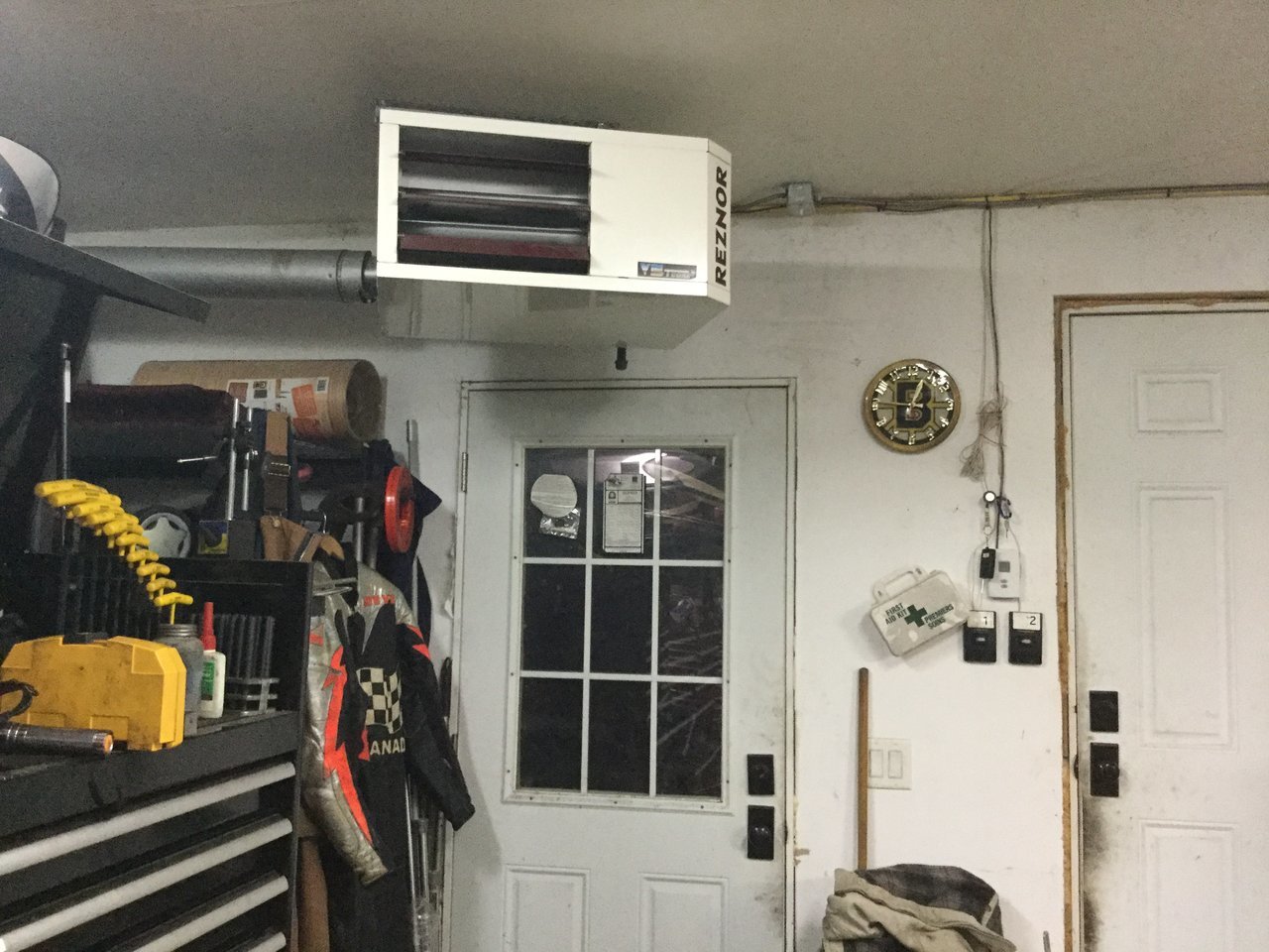

    New garage go infloor heat. Existing go gas heater. Infloor keeps the floor warm which keeps your feet from getting cold after being there for a while while radiating to the air to heat the room. You insulate all around it including underneath and it is very efficient as it takes a while to heat but the loss is low. You open the garage and lose all of the warm air but the floor stays warm so you close it up and the heat radiates quickly back into the air while the floor stays warm the whole time.
    Since my garage was existing I went with the gas heater. I keep it on all winter because I work in there year round. If I am cutting long lengths of metal I shut it off and make my cuts then close the garage door again. It heats back up fast and compared to wood or pellet stoves it wins hands down in convenience. When it gets really cold the room may be warm but the floor can still be cool.
