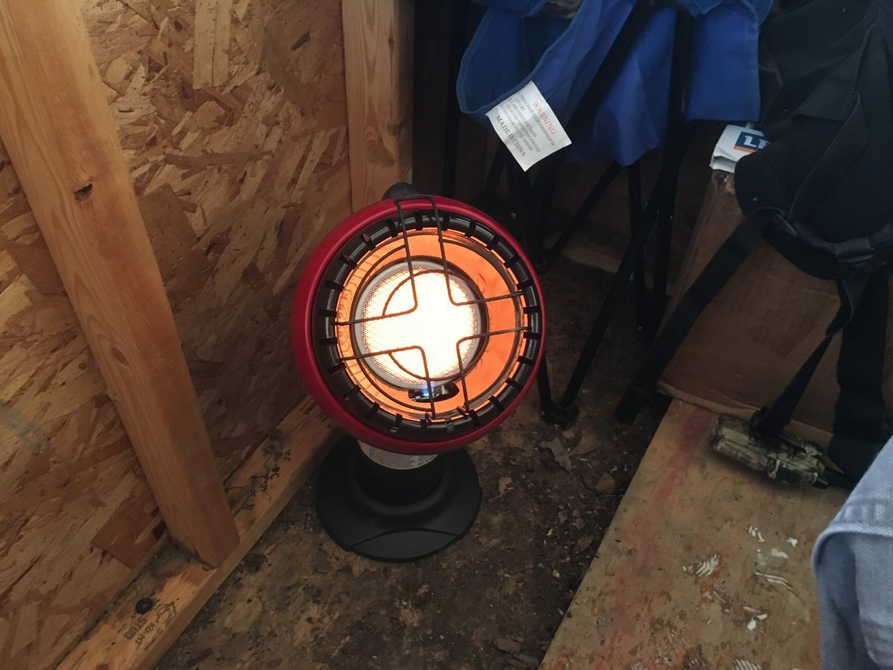

    I have a portable 70,000 btu diesel/kerosene heater and a "jumbo" cast iron wood burner. I made a blower system on the wall behind the wood burner in order to push the air around my 4 car pole barn. Just from my experience with this one, if you had a 2 car garage, a 10-15000 btu version of one of these would be enough with moderate insulation.
    I use the diesel heater to get the temp to about 50F in about 45-90 mins (about .5- 1 gallon burned) depending on starting temp. By then the wood stove is pretty warm and can usually raise the temp another 10 degrees by itself. 60F is my target for working in Winter. But if its 45F or above and minimal wind, I will usually just open the doors and go without heat. I like the outside light, and just the feeling of being outside.
    These newer diesel/kerosene heaters are quiet and odor free after an initial belch or two. If you run pure diesel, they don't like to ignite below 35 or 40F, so I try to plan my fuel usage so I am about dry after the 45 mins, then I use a little straight kerosene next time to get it hot before adding diesel. Cost saving method.
