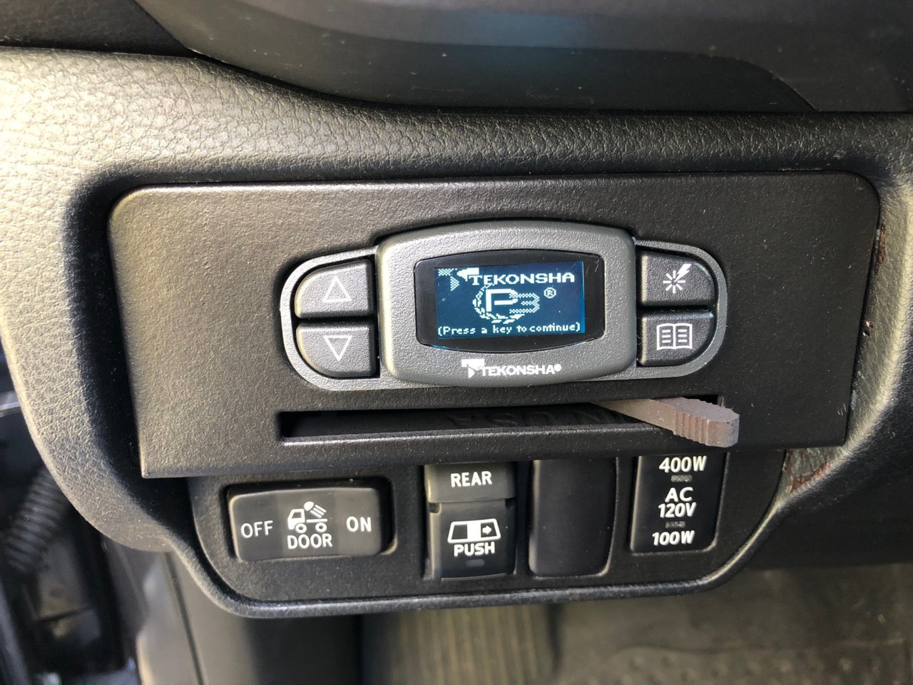

    What brake controller are you going to use? Where will you install it? If you don't need that pocket above your left knee, Meso Customs will make you one of these. The cost is about as much as the controller itself but worth it!
