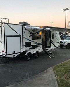

    Towing this monster. 24 ft, 28ft to the tongue. 5800lbs dry. 6k easy loaded. (Never towed it loaded).
    Flat road...put my foot off the brake, truck moves it like theres nothing. 3% grade, yeah...definitely there in the back, jumping 2800rpm from usual 2000 rpm. 40mph piece of cake. Havent tried mountain roads. 50mph still felt in control at 2800-3000rpm even down hill taking it slow. When towing I would never go above 55 anyways (socal laws).
    But then again, I have 4:88 gears 33” tires (lighter side 33” toyo 255/85/17), air bags, 2” aal, with aftermarket trans cooler hayden 679 with maradyne m103k fan in tandem with stock trans cooler and weight distribution hitch that can handle 1000 tongue/ 10,000 gross with sway bars.
    I am running 400 lbs of gear, body armor, roof rack, skids, nerf bars above stock weight. (4800lbs weighted). Tekonsha p3 brake controller is a must and by default settings, the trailer brakes me! Considering the weight, I am literally a 1 ton truck with the air bags.
    Currently in discussion of possible super charger or regearing again to 5:29 would help. Not planning for top speed, just easier on the engine/transmission. I dont care about mpg...but 91 octane only running 13mpg so far.
    I am new to this as well. But we loved the trailer so much, my family is willing to work around it, even if it means for a tundra if the taco just cant handle it.
