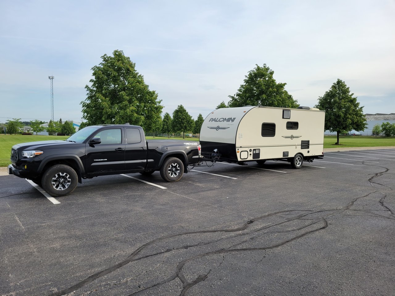

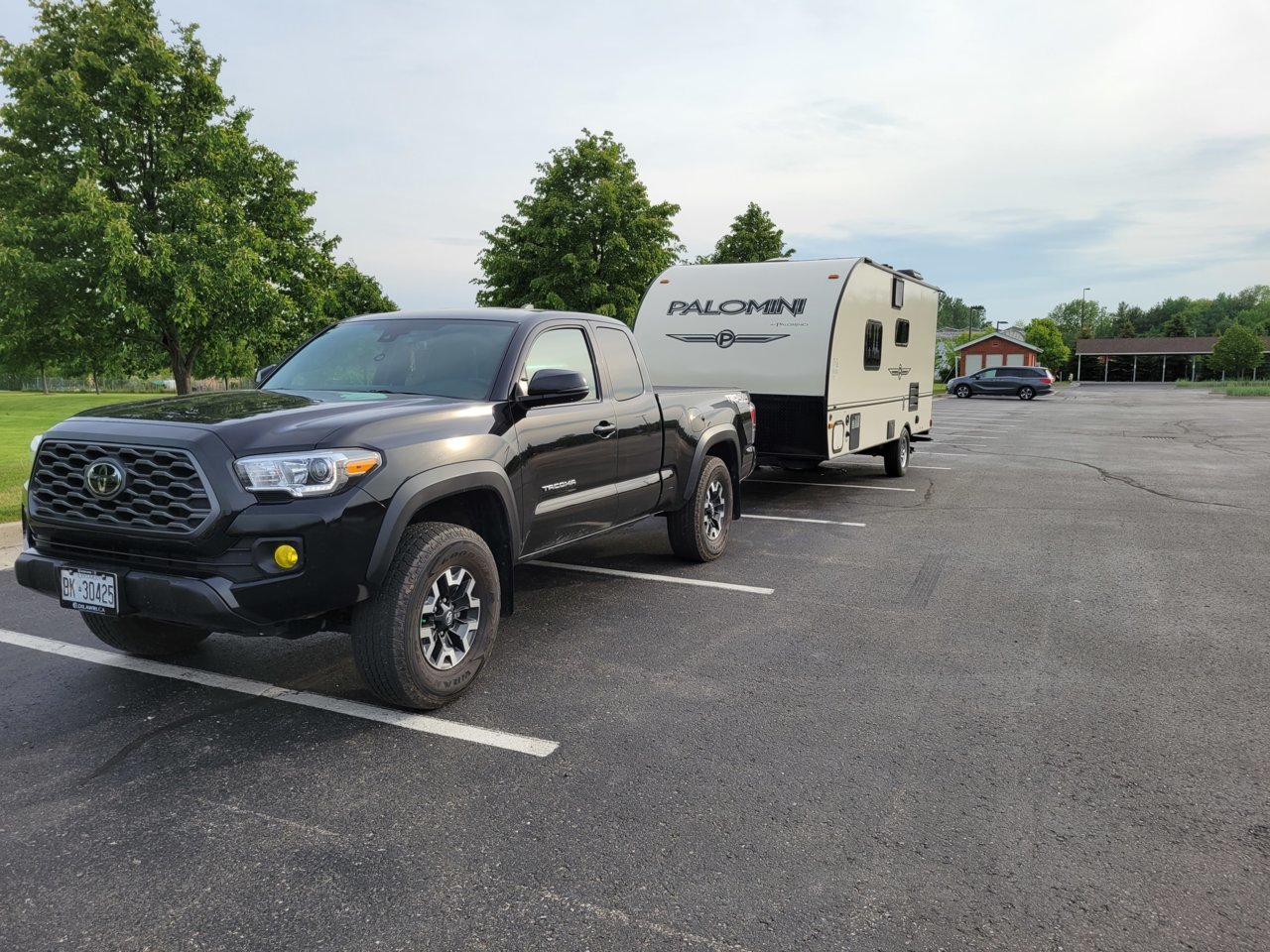

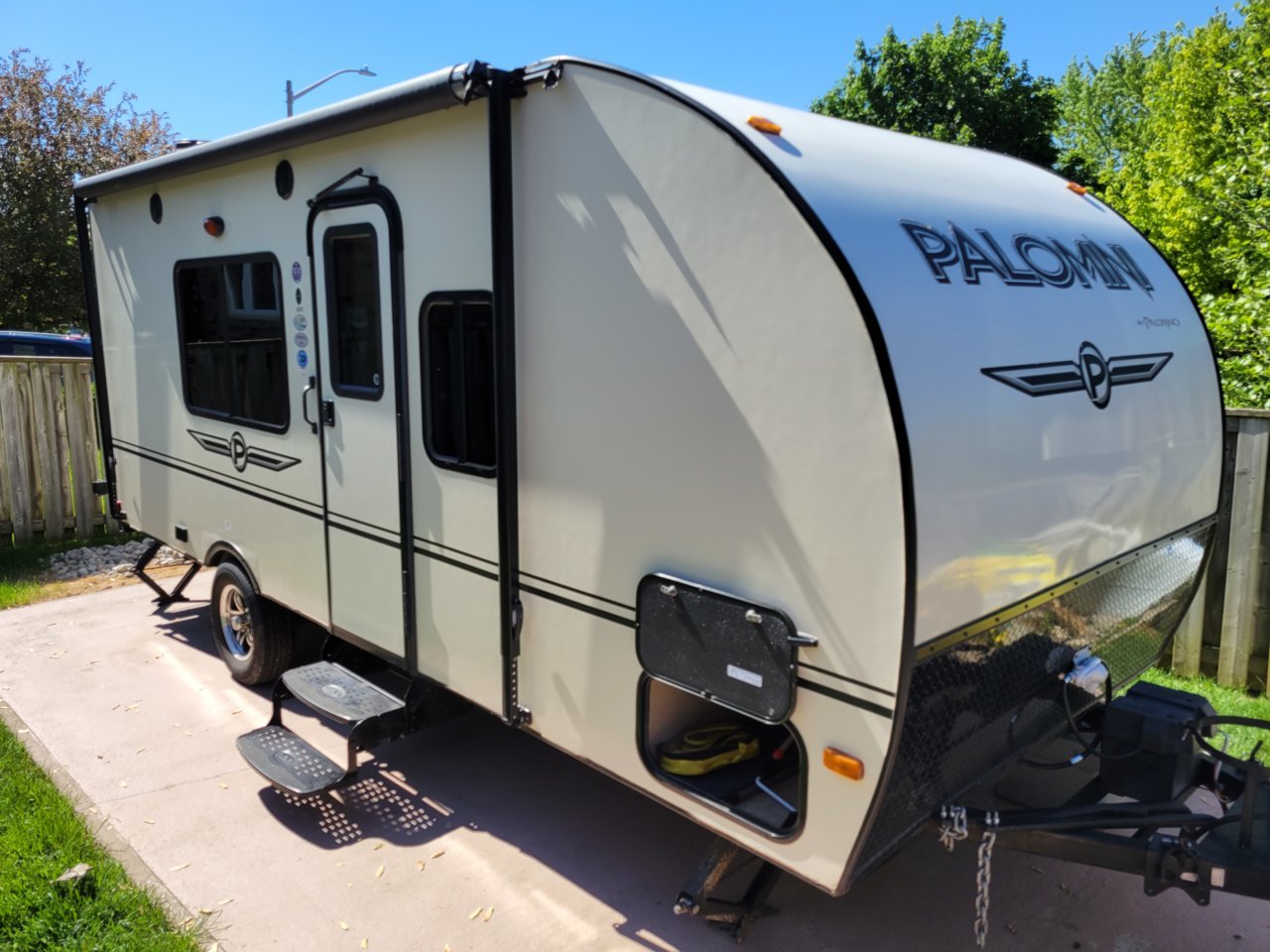

    This is what I tow, and certain years live out of in the warmer months. It is a 2015 Palomino Palomini 180FB, dry weight is 2950, loaded is 4000. I wouldn't want to go much bigger for a long haul trailer, this setup is very comfortable for long hauls with a WDH. I tow this 6+ hours at a time, and it isn't white knuckled at all.

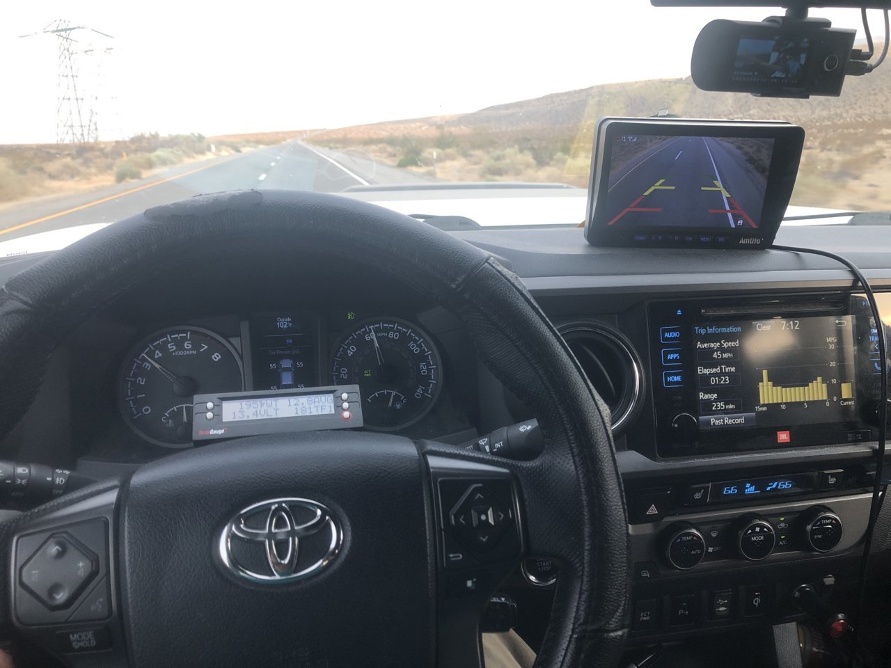

    43497951-6E19-4E4C-B9C7-4E65F00FFA9F.jpg Just came from I want to say the ultimate towing test with my set up.
    Coming from so cal to yosemite via the hwy 140 from merced (with some steep grades 6-7% then thru the tioga pass going down 8% x 39 miles (brakes could do better) as I saw little smoke coming from them. And yes I geared down to 3rd with rpms screaming. The grade is scary.
    then to mammoth lakes followed by the 395 back to socal.
    Engine temps never above 206, trans temp never above 199 via scangauge.
    ...only to go to lake mead near vegas 3 days after via the cajon pass 6% x 21 miles and a long stretch perhaps 10 miles of 6% grade at 120 degree ambient temp! my engine temp went whopping 230 degrees tops and trans temp at 220 degrees running 40mph inclines.
    To answer your question, I have no way of knowing the difference between 5:29 and 4:88 gears. I only know 5:29s you will have higher rpms as your top speed is around 80mph where as at 4:88 you can still desert run at 100 easy before rpms get uncomfortable. You also get smaller teeth at that ratio so physically higher chance of having something breaking if “breaking in” or installation procedure is not followed properly. If you never wheel above 80, even on hwy, by all means 5:29 should be good as I hear its easier on your transmission. Just get it tuned properly.
    I am more than happy with my 4:88. I run skinny tires but 33”. I like the taller tires but the weight of stock. Works for me with what I do.

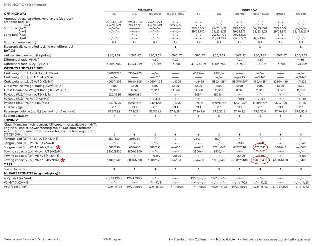

    Couple o' things... If this info is obvious to you, sorry in advance. Otherwise, there's A LOT more to towing safely than just tow rating. "Balls-to-the-wall, skinny pedal matted, hair on fire, she tows or she blows" towing is a completely different thing. If you’re asking the questions - I doubt you’re one of those guys. Lots of people will tell you what they do, and specs be dammed. Unless they hand you a blank check at the end of the day to replace your truck, or cast some kind of wizard's spell to keep your family from being spread down 1/2 a mile of highway - DON'T LISTEN TO THEM. You have to do your own research man, and that research should be specific to the trailer you want. The info is out there. After getting just a little smart (a little) on towing, I've come to realize how many accident time-bombs are on the road. Now, about those numbers...
    The "towing capacity" of any vehicle is exactly that - what it can tow, but not necessarily manage. The 6400lb rating means a sled, weighing 6400lbs can be pulled by a line with the truck. Wether or not it can be safely managed by your truck when attached is a whole other can of worms. You don't want the tail to wag the dog - ever. Every item on the truck affects that weight, AND your payload and GVWR. So, start subtracting lbs for all the neat stuff we love - bigger, heavier tires, armor, sliders, etc. The lbs add up with the quickness. It's a big surprise how much stuff actually weighs. Clothes, tools, recovery gear, water (pretty heavy at 8.3lbs per gallon), people, animals...keep subtracting lbs.
    The "dry weight" of a trailer is what it weighs at the end of the assembly line, and like someone else already mentioned, most of the time doesn't include propane, propane tanks, load outs, etc. Here's a funny thing, just as an example: a 20lb propane tank actually weighs close to 40lbs (I can hear a few jaws hitting the floor). It's 20lbs of propane without the weight of the tank, which is about 18lbs of steel. Most of us, myself included only counted for the 20lbs. That was before I was smacked in the head with the educational 2x4. Keep subtracting lbs.
    Here’s a couple of links to our capacities, but it’s always better to get them from the manual:
    https://www.toyota.com/tacoma/ebrochure/
    https://www.toyotamobility.com/mobility-solutions/hitch-load-guidelines
    Tongue weight varies greatly from trailer to trailer, and isn't necessarily proportional to the weight of the trailer. Sometimes a light trailer will have a heavier tongue weight due to the design. Tongue weight should be between 10-15 percent of gross trailer weight (GTW). For example, a 10,000-lb trailer should have a tongue weight between 1,000 lbs and 1,500 lbs. Now, for our Tacomas, depending on the model, that weight is between 350 and 680lbs. For a 2020 O/R with a M/T it’s 640lbs. That comes from Toyota, not from "my buddy tows a 24K pound whatever uphill all day and it’s fine". You'll get a lot of that in here. If you use a weight distributing hitch, that’s gonna add approximately 100 lbs, of tongue wight, so start subtracting from the 680. Also, where you load stuff quickly adds lbs to the tongue weight (a lot of crap fits under the floor in that front pass-through storage). It’s all adding weight on the hitch point. It's important where that weight goes. Check this out:
    https://youtu.be/w9Dgxe584Ss
    Gross Axle Weight Ratings (GAWR). This is a trojan horse. You’ll find this on the door jamb sticker, and it specifies each axle, and with which size tire they’re rated. For example: the axles on my 2020 are rated at 2940 lbs front and 3280 lbs rear. You would have to get your axles checked at a scale when you're loaded, obviously, but the weight of the trailer, the actual tongue weight, plus the hitch, plus the cargo greatly affects the axle ratings. Look at these two weight tickets from two different trips.
    In the pics below, look at how different the numbers are on each axle. Note there’s only a 60lb difference in the GVWR (truck and trailer). Also note this little kicker… the dry weight, or unloaded vehicle weight UVW of my trailer, per the manufacturer, is only 3634lbs (which in my case includes the propane) - but the actual weight of the trailer on both these trips is 4080 for one and 3900 for the other. That’s a difference of over 400lbs right there. The difference in the two trips? 2 days worth of food, different gear (hiking vs kayaking) winter clothes vs. spring clothes, etc. Different weight on the truck? Bikes vs kayaks, extra propane, and the most important of all - VEHICLE GEOMETRY. On the scanned ticket, the truck was at a stock height. On the screenshot ticket, it was after installing a lift and slightly taller tires, which changed the pivot points of the weight - shifting some of it from the front to the rear axle. On a WDH, those weights can be dialed in and moved forwards/backwards to better distribute the weight - as the name implies. It doesn’t take much at all. For my hitch, each washer moves about 250lbs forwards or backwards. You’ll also notice my steering axle was overloaded by a little on the first ticket, and the rear axle on the second. Physics - what a fickle bitch. Keep in mind - this is a 3600 lb trailer, that when loaded, is barely over 4K, and the axles are slightly out of spec.
    Tires. Not a huge concern, but still something to keep in mind, because a lot of us are running E-load off road tires for the sidewall protection. But the weight rating on the tire is something to look at too. The stock Kevlar Goodyears aren’t bad, but without paying attention - they can be overloaded and cause a blowout. What are you running?
    Homework time: A 5400lb trailer (per the dry weight of the manufacturer) seems to be good to go when we just look at the base numbers. The Taco is good for 6400lbs. 1000 lbs to spare, and a tongue weight (in a perfect world) of 540lbs. Clutch. Add a WDH at 100 lbs, your tongue weight is now at 640lbs already. Now, let’s add two propane tanks at, say, 35lbs each. 710 lbs. You're over. Over the 10% low-end anyway. Wait, what about all the other stuff? The stuff inside the trailer, and in the pass-through storage? All of a sudden the 5400 pound trailer, which seemingly gave you 1000 pounds of wiggle room has you over at least one of the vehicle spec limits... like evil magic.
    When you start to combine all these numbers - it’s confusing as hell. There’s no easy formula - period. EVERY trailer, even identical floorpans from two different manufacturers will have different weight ratings all over it (tongue weights, dry weights, cargo capacity, etc.etc.).
    To answer your question, “…looking at a 29’ trailer with a dry weight of 5400….doable?” It depends on how exact the weight is distributed (tongue, RR axle and FF axle). But that’s just the empty trailer. I’d bet, after it’s all said and done, people & cargo, you’ll be out of spec on one or more categories. Of course, these are all "lawyer" specs, aimed at reducing Toyota's liability. Without some destructive testing - who knows what the truck is truly capable of. For me - not worth the risk man. Not to the truck, not to my family's safety. But that’s just my opinion - your experience may vary. Sorry for sounding preachy, but no one wants to read about another TW member punching his clock for a trailer.

    The info on SAE J2807 doesn't account for variables. For starters, the OP is moving to Arizona, so will probably be loaded down pretty heavy. Here's the info from Toyota themselves, I specified a 2020 TRD O/R with A/T:
    So, let's adjust the numbers, based on the SAE J2807 "assumptions" and include the 70lb WDH which is accounted for in Toyo's Spec sheet as TSC. 5400lb trailer (dry), unknown if that accounts for LP tanks, 10% tongue weight is 540lbs. In this example, that only leaves 100lbs of room at the tongue. 100lbs, for a person moving across the country, for which, according to SAE J2807, does not account for any cargo. Physics - fickle bitch. I'd trust Toyota's specs, which are specific for their vehicles, over a standardized test any day. Your experience may vary.
    Now, you're saying that "Taco is rated for the load as stated and can manage it." If you go with that, then anytime you go out camping with a 6K pound trailer, which the Taco is rated for, you take nothing with you. No gear, no food, no water. Because you're only 40 pounds below the rated tongue weight...that's a cooler with ice and 2 gallons of water in the bed, or 2 lawn chairs and a few Coleman lanterns in the pass-through storage. Add a kid or a dog in the cab?

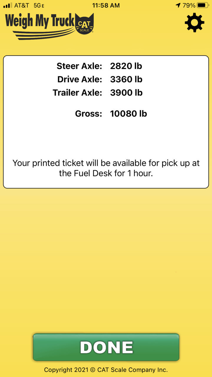

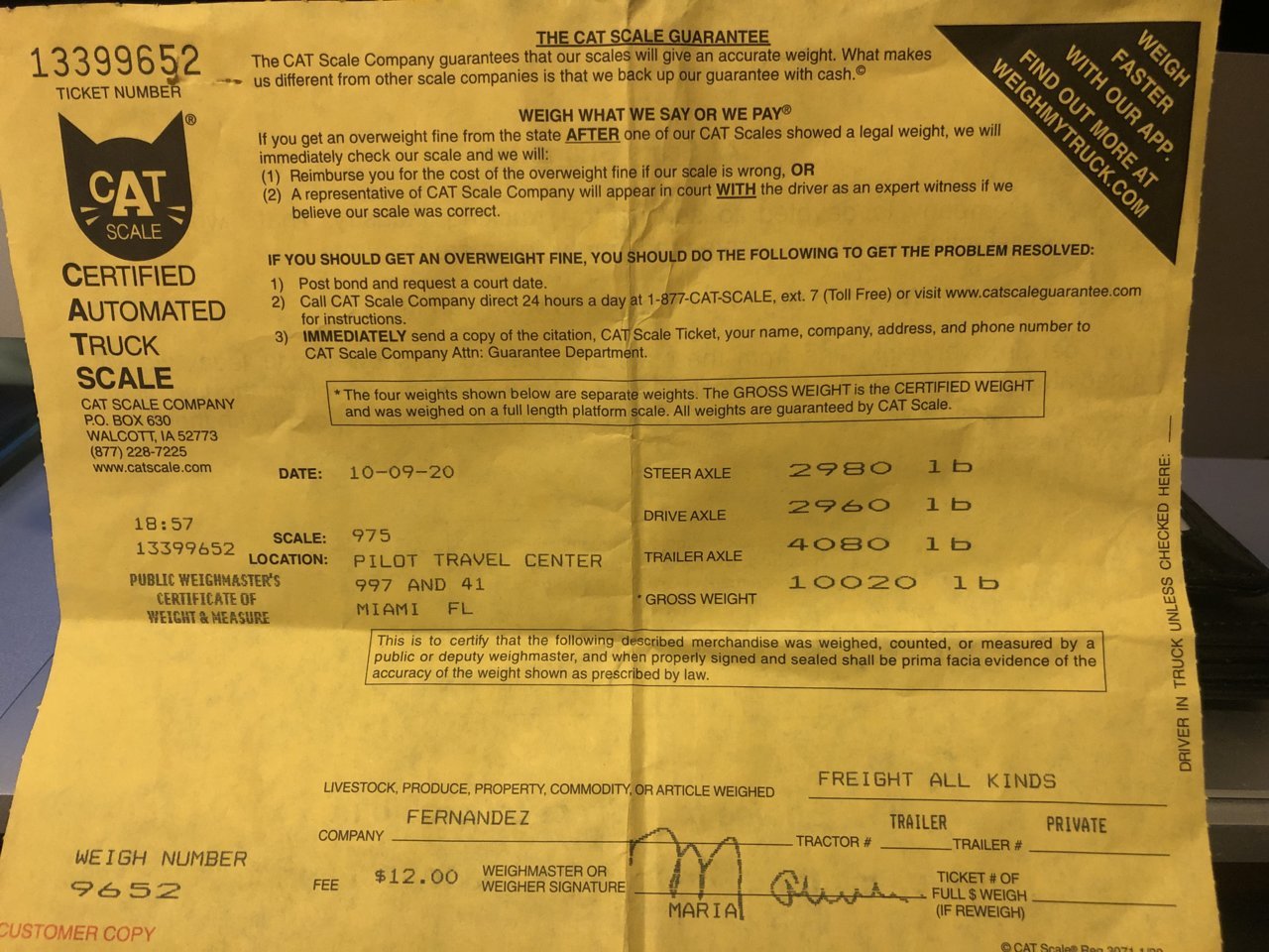

    I'd also like to point out the real world numbers from the CAT scales with a 4K pound trailer and a conservative amount of gear - like 2 bikes or a pair of kayaks. Axles are at or above the max. When you put a WDH on a 6K pound trailer (for which the Taco is rated mind you, and is specified on their chart) what do you think the weight will be on the axles? SAEJ2807, when used with Toyota's specs and real world numbers is kinda flawed. But that's the problem with testing for ANY consumer product...no one wants to fail, so the tests are administered with some pretty precise parameters well hidden by the "ooh, aah" numbers. Thus endeth sermon. To each his own.
