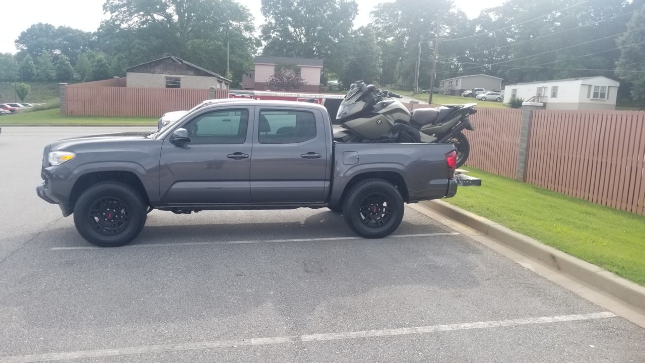

    I did this....but due to last minute circumstances. Had a Uhaul lined up when i got to Uhaul in SC but no trailer in sight and could have one in am but for triple the price I had signed up to and did a deposit for online! A bad day for sure as I had been on the bike nonstop to Spartanburg SC from WV to get my SR and needed to be back early next day.....I had to load this 800 and change bike by myself. I went to Lowe's and used 2 x 8 for a center rail for the bike to rest on. At the tail gate I raised the 2 x off the tailgate with a cut shim. Bike was fine on back but not something I would want to do on a regular basis....though if doing a one way rental on a trailer and it was ridiculously high....hmmm....
