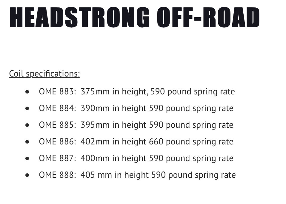

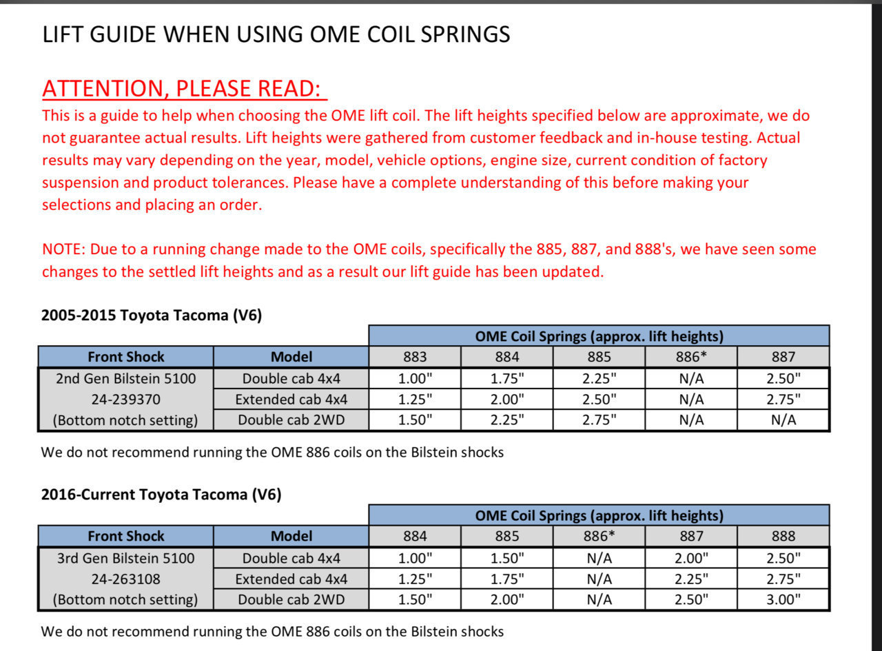

    I notice on headstrong offroad they don't have an option for 886 but they do have 887. Whats the difference?

    I should say, I saved that information off the Headstrong website.
    I don’t remember where it was I found it though?

    That list doesn’t really mention weight, so is that all based on the assumption of stock weight?

    Last I saw OME 884/5/7/8 coils are 590lb spring rate and the 886's are around 640lb. It may have changed its been a couple years since I saw those specs.

    I suppose it is based on stock.

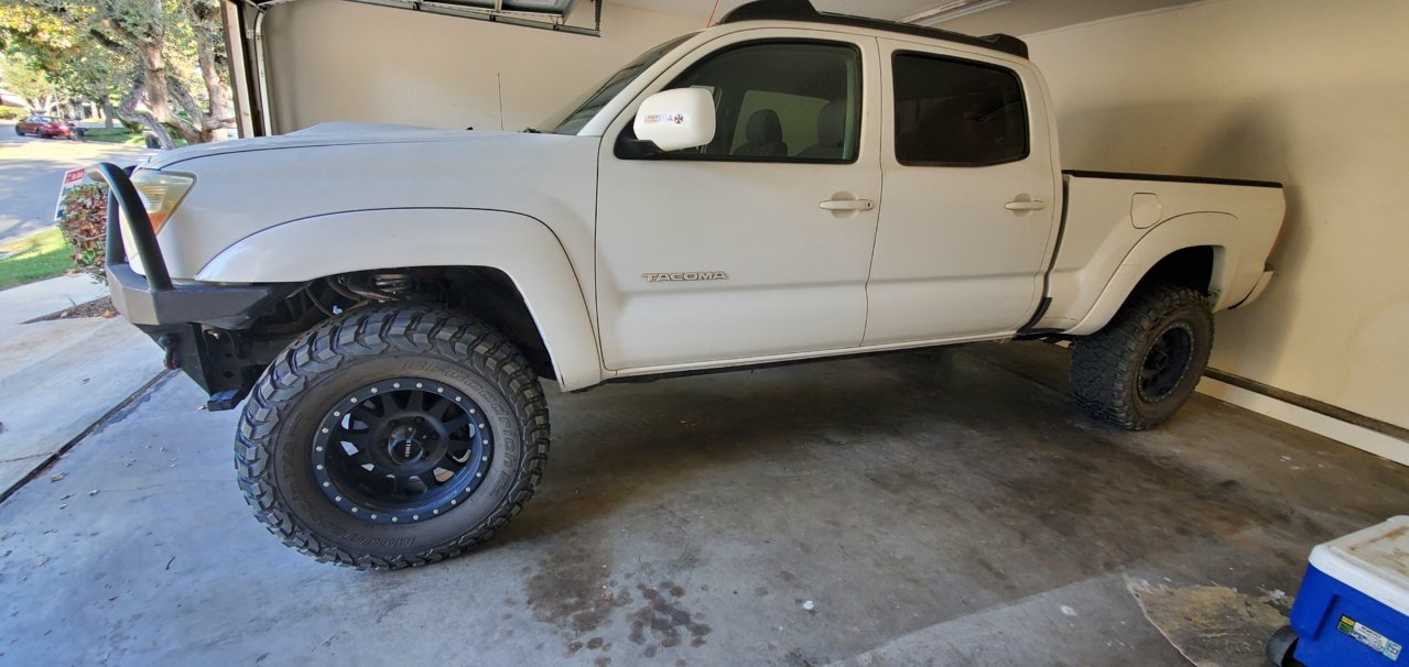

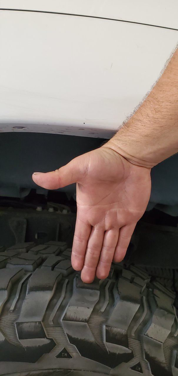

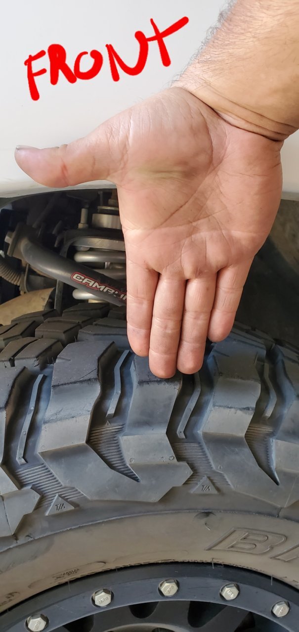

    I have a set of Billy's 5100 with 600lb coils from toytec. They worked perfectly when I had just the plate bumper on it but once I added my winch it started to sag. As you can see in the picture. I changed to fox extended travel coilovers and it was like night and day. I would say they were for sale but this is not the correct thread for that. The last picture is with the winch.
    TnShooter likes this.
