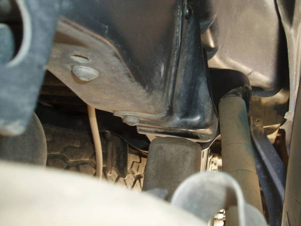

    Hey everyone.. I'm looking for some input here;
    I own a 2005 Access Cab TRD Off-road. From what I can find, the "Off-Road" package increases the max payload capacity to 1375 Ibs. I'm currently purchasing a 6'10'' camper made by Northern Lite that weighs approximately 1200 Ibs when you add all the extras (propane, jacks, aluminum rack on top etc..). To compensate, I'm getting Airbags installed ("Firestone" brand, "Ride Rite" model). I also have some good, aftermarket LT tires with a decent Load range.
    I'm looking for some advice for those of you who have "maxed-out" the pay-load as I am. Can I do anything else besides the airbags. I must say that I'm a little disappointed about the payload capacity of my truck. The towing rating is great for the size at 6500lbs, but it sure can't (legally), carry much.
    As for my leaf-springs.. I'm a little confused about whether MY truck had the crappy springs I'm reading about.... A year ago, a friend of mine with a 2006 TRD Double Cab "Sport" model had his rear springs replaced after complaining about it "bottoming out" and squeaking. Wanting to prevent a similar problem, I went into a dealership and they did replace my rear springs ONLY. It seems however, that the "new" springs are only 3 leaf. If I remember correctly, the "stock springs" they replaced were the same "3 leafs". Was there an actual recall on these and is my truck included? How do I know if the new springs are any better than the ones they replaced?
    Can I anticipate a problems using these springs with the airbags?
    Thanks for your help!

    Forget it. You can NOT increase the payload capacity of the truck by adding airbags or springs. I'm assuming you're talking about a truck camper right? (because if it's a towable then it's a non-issue) If the DRY weight of the camper is 1200# once you add your gear, food, water, propane, etc.. you're going to be way over the 1300# of the Tacoma. Then don't even think about putting any passengers in the cab. I loaded up 2000# of dirt (I did't realize it was 2000# until I offloaded it and it was weighed). This was before I added my roadmaster springs. I was on the bumpstops and darned if the truck felt squirly going around a corner even at 25mph. No way in heck would I take it on the freeway.
    That said.. I tow a 5000# travel trailer as well with about 600# or so of tongue weight. With my roadmaster springs I don't get the sag I did without them. You really have to be carefull how you load up the "little" Tacoma. It's a great truck but it's more of a trail truck than a "real" truck if you know what I mean. If nothing else you'll add that camper in the bed and wear out your truck pretty quickly.

    Airbags can most certainly increase your payload. Remember that 2000#'s of dirt you were talking about? With airbags you would have been off your bumpstops and adjusted them to have a level truck, which would have solved your squirrely steering issues you had. NOw adding airbags doesn't mean that you can grossly overweigh it, because other things like your brakes stopping power come into play.
    If I had a camper, I would most definately add airbags and possibly better springs. Personally I would just try airbags first, they will make your springs and shocks last longer with that camper on there, and your handling will be better because you won't be dragging ass with little weight on the front.
    The nice things about airbags over getting a set of springs to handle you camper, is that a set of springs made to handle that camper and give you a level ride, will be brutally harsh when you don't have the camper on. With the airbags, you can retain you stock ride when you take the camper off.

    Oh sooo wrong... springs, airbags, etc.. do NOT increase the payload rating of your truck and you are still subjected to the GVWR of the truck. Payload is the GVWR minus the dry weight of the truck. Airbags and such may only help to level things out a big where the stock suspension may be a bit soft. If you REGULARLY load the truck over it's GVWR you risk the potential of damaging stuff. I personally added a set of Roadmaster Active Suspension springs to my truck to help with the ride when towing my trailer but it does NOT allow me to add more weight in the back end. That's dangerous to think that way.
    FYI.. even if you're level you still can be overloaded as too heavy of a payload will have a tenancy to take the weight off the front wheels causing steering and handling issues. Yes sure you're riding level if you add airbags but the weight is still having it's affect on the front end.

    I am not just coming to this with no experience in hauling both with stock suspensions, airbags, helper springs, etc... I never said that it allowed you to grossly overload your truck, but it will allow you to safely carry a little more than the recommended load. Heck, it will allow to be even safer with a load that is somewhat close to the max as we all know how bad the original 3 leaf spring pack sagged with even a mild load, let alone a full max payload.
    Yes, weight in the rear will play a little part with the weight of the front, even with airbags, but nothing like how it would without. Again, I'm not talking about grossly overloading.
    The whole payload thing is relative and crap anyways due to the fact that it was for those weak ass springs. Yes brakes and other stuff come into play, but if it's rated to stop it and a trailer of whatever the trailer payload is, then I can guarantee that a slightly over max load with airbags is going to stop just fine. I'm not trying to say it will turn it into a one ton truck or anything, but to tell someone that airbags won't help is retarded. I'd rather see a guy with just over the payload and airbags going down the street, than a guy with just under the payload and the bumpstops are hitting the axle going down the street. Which one is safer, the one that handles closer to stock, or the one swimming down the road due to the extremely light front end and the bumpstops smacking the rear axle with every dip?
    And I've tried this with other trucks to test this out. I use a Dodge one ton truck sometimes for my tile business and it has airbags added but stock springs. I've had a load in it, no where near the max load for the truck, and no air in the air bags. Power wise it was fine, but handled like crap, put some air in the bags and it went back to handling fine. Another time load at the max and slightly over with air in the air bags, and it handled just fine and way better then the no airbags way under the max load.
    Also, knowing how to load your load is going to help as well, and of course airbags/no airbags with a load you have to realize your braking time is reduced and you need to adjust your speed and driving habits accordingly.

    Well, I found this forum again after completely forgetting about posting this in the first place! The outcome was quick and simple; Bought airbag suspension, didn't bother with different springs and my truck handles my 1990 Northern Lite 6'10'' camper beautifully. Also added 10 ply tires for the extra weight and 'rough road' camping. Other than the usual crappy gas mileage that comes with camper wind resistance, and the fact that my brakes are being used up a little quicker, I'm SUPER happy with my camping package. I realize going over the GVW isn't the best-case scenario, but let's face it, even most full-size trucks are going over weight with the gigantic campers being carried today. My Tacoma handles this package just fine..
