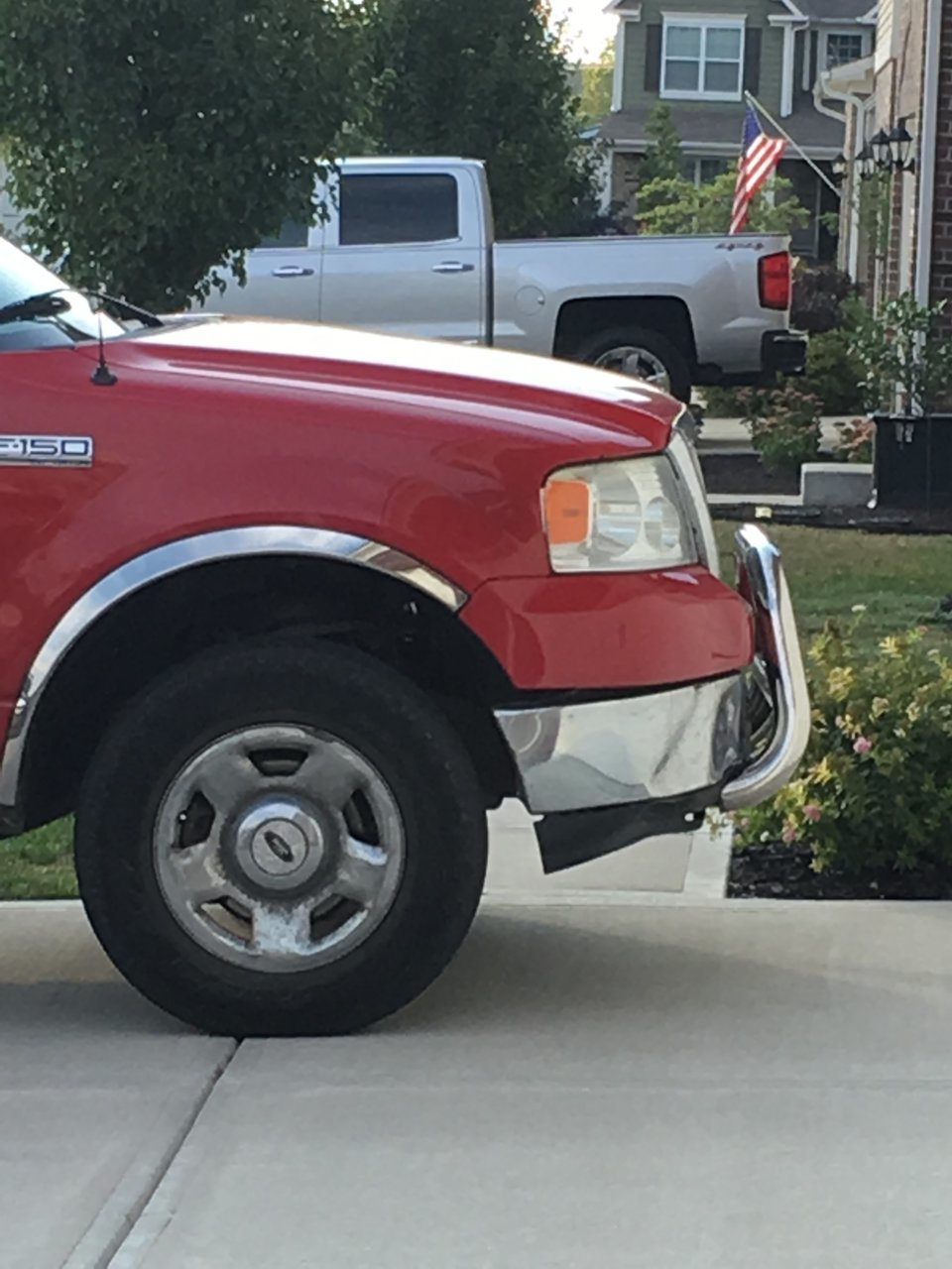

    The guard attaches to a mounting bracket behind the bumper (which is not solid). When something hits the bumper it bends the guard which forces the mounting bracket to bend.
    Torque = Force * Length
    The guard extends the length of the mounting bracket so it means less force is required to damage the bumper.
    Below is a picture of what I mean:
    The bar just ended up bending the bumper. It doesn’t do jack to protect it.
    Only guards mounted to the frame prevent danage in a hit.
  13. Oct 22, 2018 at 10:31 AM
    #33
    Steves104x4
    Steves104x4 Well-Known Member
    Apr 17, 2010
    #35468
    17,234
    Steve
    Buffalo NY
    2010 RC 2.7 4x4
    BUCKLE UP! It makes it harder for Aliens to pull you out of your Truck.
    Ya....... and it came off a Ford Ranger :p
  14. Oct 22, 2018 at 10:32 AM
    #34
    Steves104x4
    Apr 17, 2010
    #35468
    17,234
    Steve
    Buffalo NY
    2010 RC 2.7 4x4
    Saved the grille
  15. Oct 22, 2018 at 10:32 AM
    #35
    Old Marine Cal
    Old Marine Cal Well-Known Member
    Mar 21, 2017
    #213937
    6,003
    2015 MGM DBLCAB
    So the bumper got bent with
    But wouldn't it, the bumper, have been bent without it????
    More voodoo science...

  16. Oct 22, 2018 at 10:36 AM
    #36
    PackCon
    PackCon Well-Known Member
    Jul 14, 2015
    #159449
    11,569
    Connor
    2017 Subaru Forester Limited
    No the bumper would not have bent that way if the guard wasn’t there. I think thats obvious.
    I also think you need to look up what Voo Doo is...
