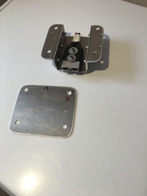

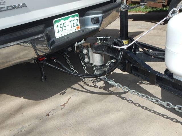

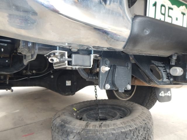

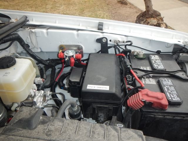

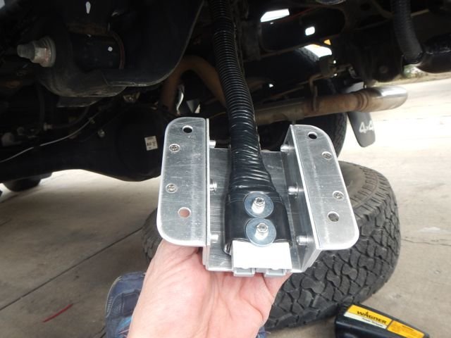

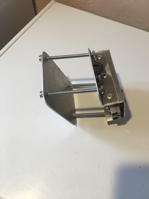

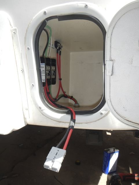

    Here are a couple pics of what I did. They show the bracket that I made to hold the SB50 connector. It bolts to the hitch crossmember next to the 7-way. The 8 gauge wire runs parallel (but separate) to the trailer's factory charge wire, all the way back to the battery compartment, where you can see the fuse and the SB50 that serves as a battery disconnect

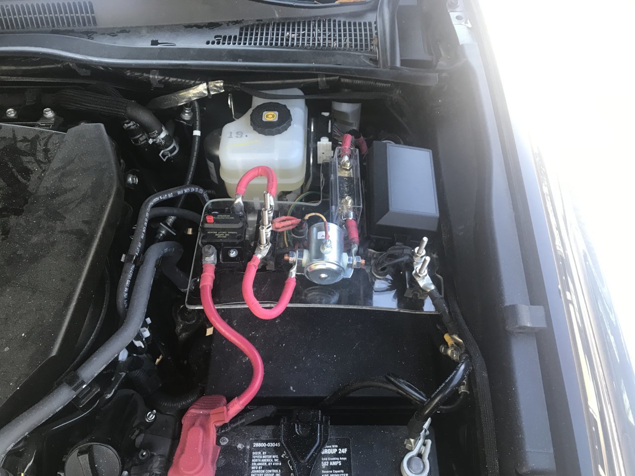

    I posted this in another thread but here’s my set-up, basically the same as he OP.... 4ga wire, both +and- from trailer to truck, continuous duty solonoid activated by an ignition powered circuit and switch in cab. I have a 50a self resetting CB at the trailer end and a fuse at the truck end. When I run the dump trailer it pops the CB after 10-15 seconds but once done it resets itself. I’ve been dumping lots lately with no flat battery like previously. I figured I may have to put in a proper Dc-dc charger and likely should to properly charge the battery but it’s working fine for now
