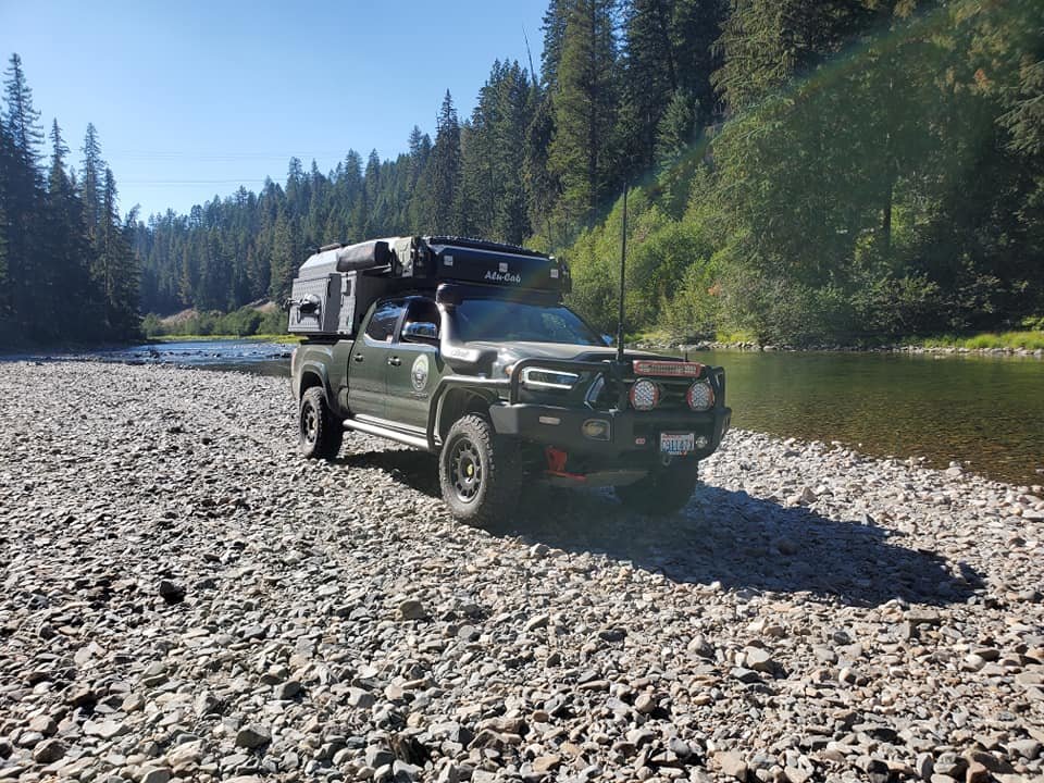

    Heres my heavy pig, 5700 fully loaded with a bedfull of spare parts.
    Running 2.5 Foxs up front with 600lb springs, sitting at 1.75" of lift.
    Chevy 63" leafs in the rear, with 16" Carbon shocks.
    If I were you I'd give the Carbon shocks a try. They are pretty good build quality, and have held up through a ton of abuse so far. About to go with their coilovers for the front of mine. Just under King/Fox exterior quality, for half or two thirds the cost and basically no lead times like everything else.

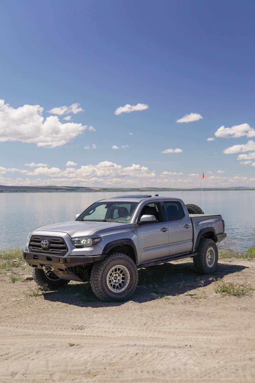

    I'm running the full Dobinsons MRA suspension front and rear.
    I have the C59-352 springs up front and the L59-111-R leafs in back.
    Even with full steel skids and rock sliders, the front doesn't seem to notice. I'll see
    when I install the plate bumper and winch.
    The rear only has a Diamondback HD cover and some gear to weigh it down right now so I'm confident I
    can add quite a bit more. Also, the Dobinsons leafs are nice and quiet so far. (about 2 1/2 months)
