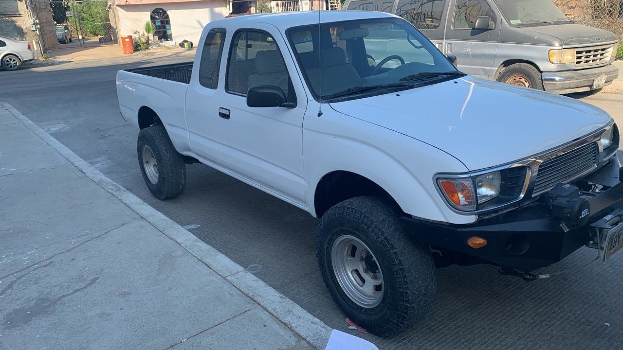

    This is my 96 4X4 auto with an AAL (add a leaf) in the rear and IIRC A fox strut with the stiffer coil. Front bumper is 10 ga hot rolled and an 8k winch. Rides great
