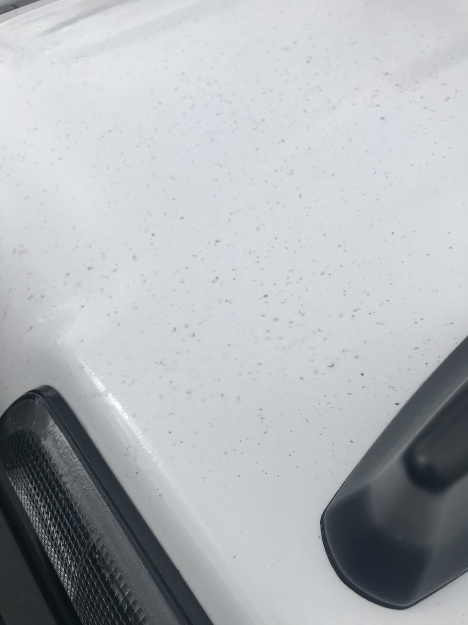

    Currently in the process this morning of removing specs of Iron that attached themselves onto the clear coat.
    1. Going to be using a acid free, non-caustic, pH balanced cleaner first.
    2. Then I will clay bar with lubricant to remove any extra crap that the cleaner didn’t get.
    3. The last step I’ll be using a wet surface polymer sealer.
    Ill update as I go through the process.
    This first photo shows the heavy metals in a section on the rear of the truck. These specs are over the whole truck.

    So from a distance, you can’t see what’s happening as I applied the product.
    The macro photos tell a whole other story. The purple you see if the heavy metals being broken down by the cleaner.
    Let that sit for a minute or so, then spray down with water to neutralize it, and wash it away.

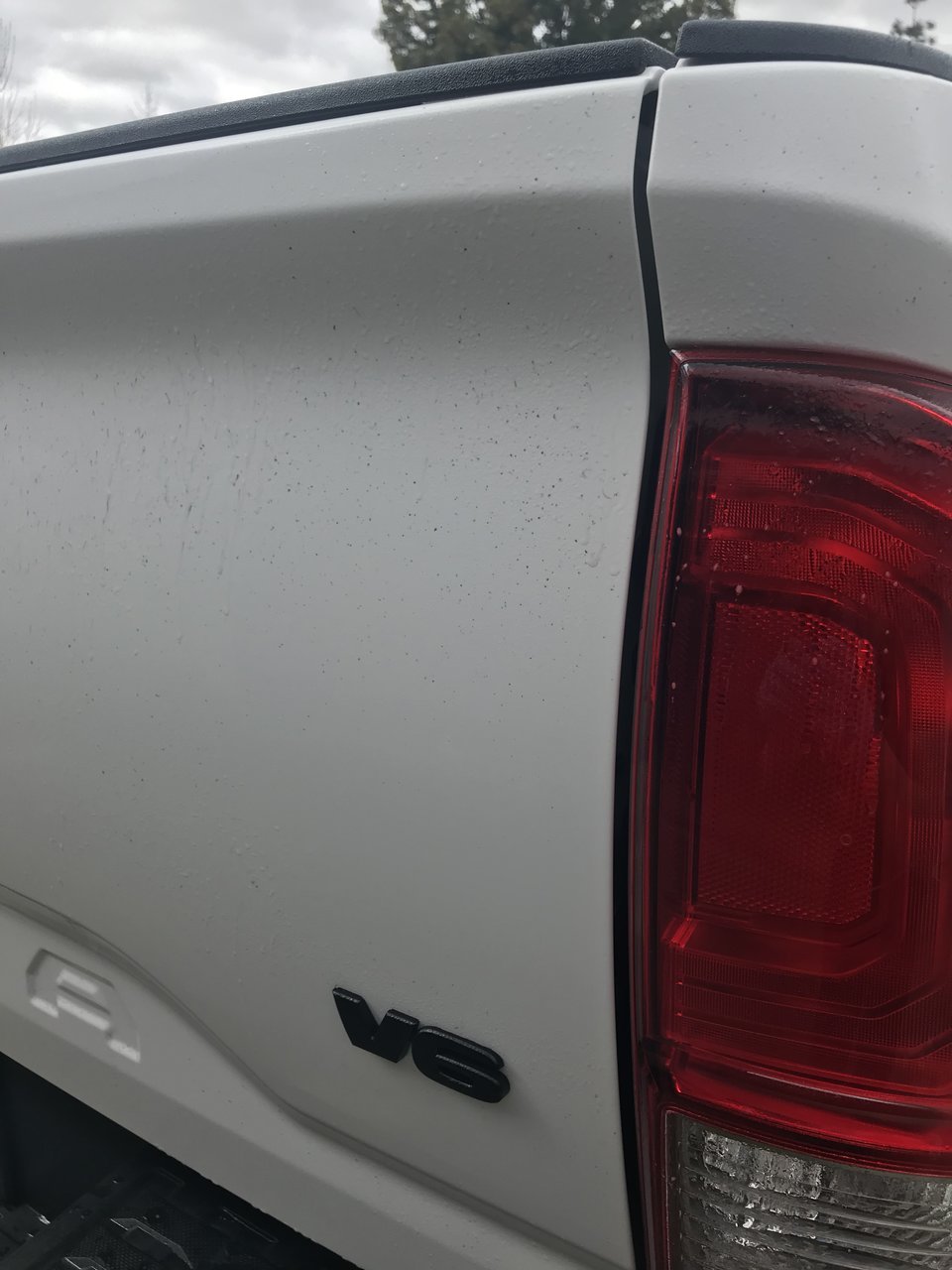

    That’s the cleaner breaking down those rust spots(heavy metals). It turns purple as it’s breaking down.
