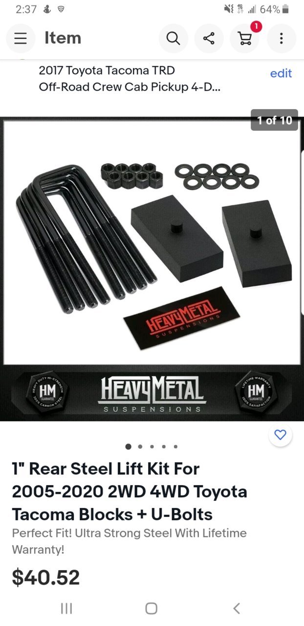

    The cost seems low given the high quality description. Anyone has any thoughts or experience with this 1 inch rear lift? All hardware included.

    block lifts steal your down travel so they are not popular solutions around here for the most part.

    Rear blocks can magnify axle wrap, which generally makes for shittier handling. That's why people turn their nose up towards them.

    If you don't carry weight in the back, 1" is just fine. The OEM TRD Lift consist of a 1" block.
