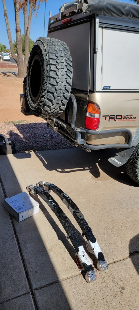

    So if I can chime in.i went and got my truck weight. I went with about 3/4 of my camping load, it was with extra gas, water, tools and camping gear. Full tank of gas 2 people.
    Truck weighted in at. 5,460.
    I have been running a j59 pack with a Dakar add a leaf to try and help out.
    Just got back from a camping trip and was just in time to meet the ups with my new alcan's I think there 500 over stock.
    frenchee[OP] and Area51Runner like this.
