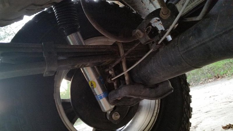

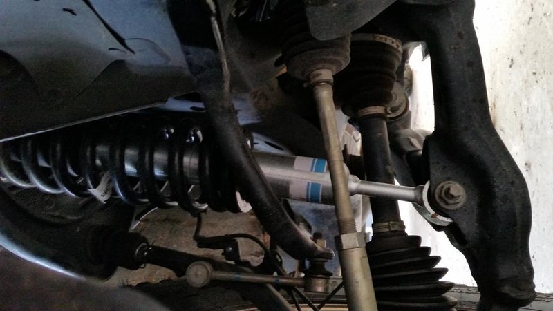

    I just put the headstrong bilstein lift with deaver aal and ome 885 coils set at 0. Had the dealer aling it got caster to 1.7 and 2.0. Drives straight. when driving the thing sways all over the place. If i go into a corner it feels like the back end is gunna come out from under it. this is my only vehicle and i have 3 small kids. I need it to not do this. Also have a noise in front end that sounds like the tire is rubbing something but its not. Please help. At a loss here. Have 4 new 2657516 cooper st maxxs on the truck as well.

    Sway bar is connected. Have no idea how to upload photos from phone. I dont have a computer. Could the fact i have wide 10 ply tires on stock narrow wheels cause the sway. I didnt seem to do it till the tires and alingment happened

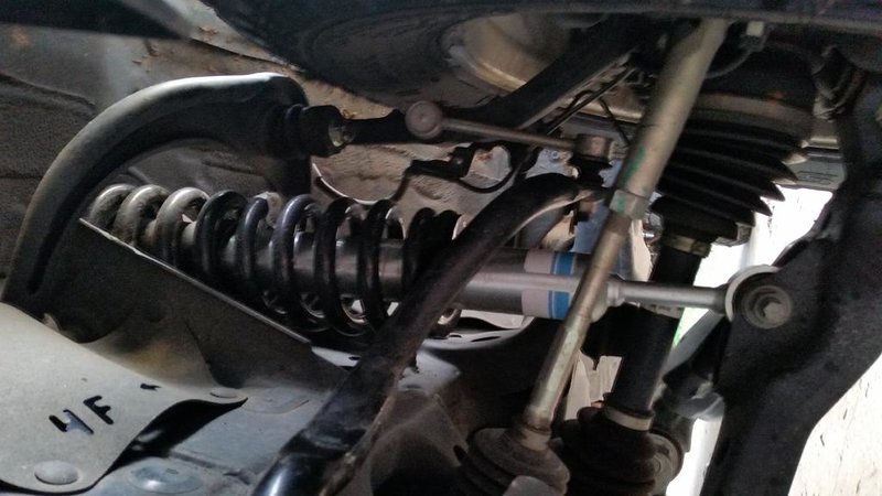

    Figured out pics

    That rubbing noise may be the disc brake backing plate rubbing the disc. Take a look, find where it's touching and pull the plate inward and away from the disc - ask me how I know :D

    Its in alignment. 1.7-2* is about the lower limit id allow on caster, But id bet you have zero toe, or are towed out. you want just a smidge of toe in.
    And the "rubbing noise" does it go away when you pop it into 4hi? if so thats the front diff needle bearing and you will need to replace it with the East Coast Gear Supply front diff bushing.

    Okay checked everything over took it out for a ride to figure out exactly where the sway happens. Its deff all in the rear. The front is responsive and the rear end sway all over hell. Actually set off the stability in a corner it swayed so bad. What tire pressure should i be running? At 40 right now thats what dtd told me to run them at. Had them at 35 and did the same thing. Could it be caused by reusing the u bolts?

    I would bet on the needle bearing after your last post. Can't help in the back. All I can think of is the ubolts or something else is loose.
