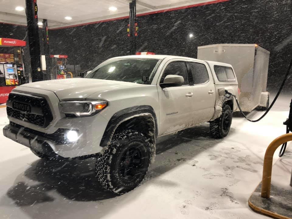

    This is my 2017 DCSB TRDOR, just got finished towing an overloaded trailer (6,100lbs+) from coast to coast. I've done the same drive twice in an 08 FJ and I think the Tacoma did much better with it. I have OME suspension with heavy springs front and rear. A trans cooler and temp gauge is a must, I have a B&M cooler and I run an UltraGauge MX. I ran my cooler in line with the stock cooler. I also have an OVTune installed which I would recommend. Everyday livability is improved and there is real power to be gained with 91/93 fuel and the performance tune. Beware that 93 octane is not available in all 50 states. The newest iteration of the tune also can disable the Atkinson cycle which should help with towing. I didn't think the trans hunted for gears much other than trying to stay in OD but the OVTune had already helped a lot with shifting oddness before my trip so YMMV. A tow button would be great for OD but no such luck with the tacomas but OVTune has a gear lock feature which can disable OD. The trans temps are overall higher but don't fluctuate as much with the 3.5 V6 compared with the 4.0 V6. I have KO2s which I inflate to 80 PSI when they are fully loaded. I would recommend a load range E tire if you are going to tow on the regular.
    I tow a couple times a year for long distances and my truck is my daily. I'm happy every time I get in it and drive it but when I'm towing I wish I had a tundra. If I have to make the trip again I will install air bags, even with heavy springs there is enough sag to blind oncoming traffic. If you are going to tow at capacity on a regular basis do what others have said and get a Tundra, the tacomas aren't designed for heavy sustained towing. Its not that they are "bad", they are a tool for a different job.
    About your questions. For towing near capacity you MUST have a trans cooler and trans temp gauge. I would recommend the tune for the power, shifting, and gear-lock. If you arent doing suspension any time soon get airbags ASAP. The stock leafs start to sag under the weight of a camper shell. Load range E tires arent a must but improve the ride and handling while under load.
    I ran 4.88's on my FJ and I didn't feel like it made much a difference towing over stock with 285's. I cant speak to the 5.29s but I assume they would help.

    Does the trailer in the picture weigh 6100 lbs?
    Junkhead likes this.
  7. Apr 5, 2020 at 10:25 PM
    #87
    bees015
    bees015 Well-Known Member
    Mar 5, 2019
    #285479
    85
    Sacramento, CA
    2017 White Tacoma TRD Offroad
    OME 886/HD Leafs w/nitrochargers LVL8 MK6 16in Wheels w/265/75/16 BFG KO2 Rigid Ditch Lights w/CaliRaised Brackets Various MESOs B&M Trans Cooler WeatherTechs LED Hi/Low w/Fogs Pop N' Lock Tailgate UltraGauge MX HD Front Brakes OVTune 1.05 2000 T4R SOLD 2014 RAV4 SOLD 2008 FJ Cruiser RIP 2010 Scion tc
    The bed of the truck plus total trailer weight was right at 6100.
