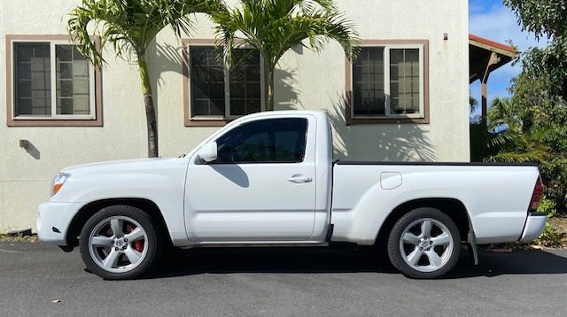

    In the interest of thinking outside the box, the 2.5” ID spring will not work with our stock top hat - at least not in the way the stock spring does. In looking at the stock hat, it does seem that there is enough space for the spring to sit inside the spring retainers (rather than outside like the stock ones do). The spring force is still applied and distributed over the mount, which is then applied to the shock mount on the frame, and the spring retainers still do what they are intended to (just in the opposite direction), so the set up still works like the stock one does - though I’m no engineer or suspension expert, so I can’t say whether this is safe or not. I also don’t have the springs to give it a test fit.
    Anyone with expertise want to chime in? Or maybe wants to the the first to try it? :D
