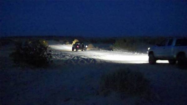

    Can we see some pictures from the drivers seat at night thanks in advance. Nice conversion btw.

    Still waiting on those pic's and waiting and waiting :rolleyes:
  16. Apr 23, 2010 at 12:11 AM
    #36
    Dellosa89
    Dellosa89 [OP] Love peace and Taco Grease
    Dec 6, 2008
    #11334
    1,319
    Brian
    Murrieta CA
    07 Prerunner TRD Off Road
    Fox 2.5 Coilovers, Camburg 1.25" UCA's, Icon RR, Icon aal,EVS foam bump stops, Borla Catback, HID Headlights and fogs, Defiant light bar, 3 hella 700 hid, Satellite Radio, Sony hu with 10'' sub, custom jetski rack, TRD seat covers, secondary air filter removed.
    Haha sorry just check this thread.
    Here is a pic nothing great. Ill try to update with new pics soon.
  17. Apr 26, 2010 at 12:28 AM
    #37
    MJonaGS32
    MJonaGS32 MJ on a GS
    Apr 14, 2009
    #15949
    12,415
    MJ
    SF Bay Area (East)
    07 LT 4x4 DCSB 6spd Vagabond
    Drifter wedge camper, Dual battery, OBA, ARB locker, 4.56 gears
    Damn this thread.
    I just bought a pair of the 700ff lights. Getting ready to do the conversion.
    Which bulb kit did you order from the link? The Apexcone, DDM, or Porsche one?
