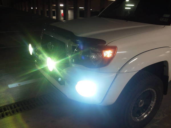

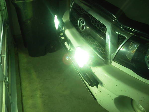

    Finally got around to doing the conversion on my 500s. Went with 35w 3000k in them to have some nice fogs. The actual fogs in the bumper are already 5000k. Not done with all the wiring but did test last night and the lighting is pretty good. One of the bulbs had a loose wire on one side so ordered another pr of bulbs so I'll end up with a spare bulb after all said and done. Both ballasts good. Running wiring to 2nd oem switch. Going to auto parts to get some loom and other bits to tidy up install. Pics later when done.

    Wow that looks great! I might actually do this...
