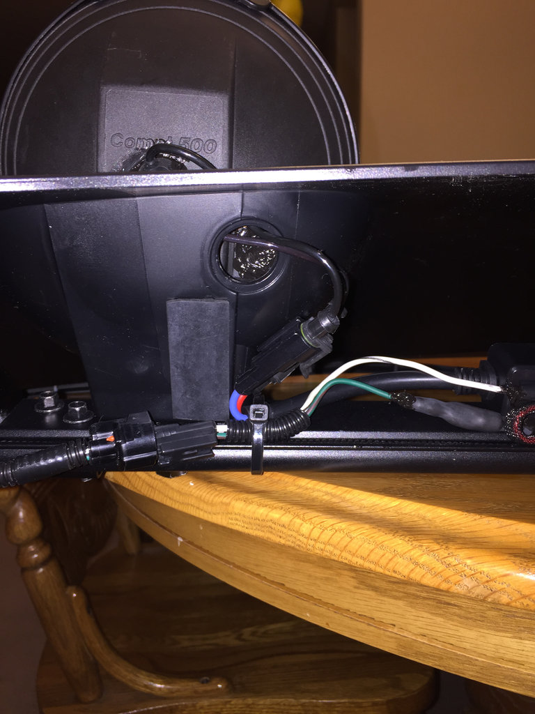

    just ordered my 55w 5k hid kits, 2 of them ;) 4 hid hella 700s, 42"bar , 20" bar, and led pods should do nicely to help me see when im out lol. ill post pics on how it goes.

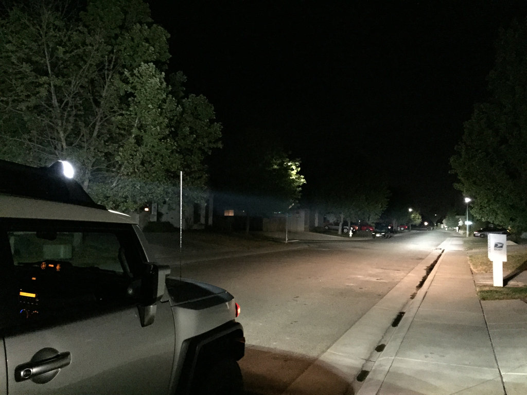

    not 700ff's, but here are my hella 500s retrofitted with 55w 4300k HIDs. really love the output and beam pattern.
