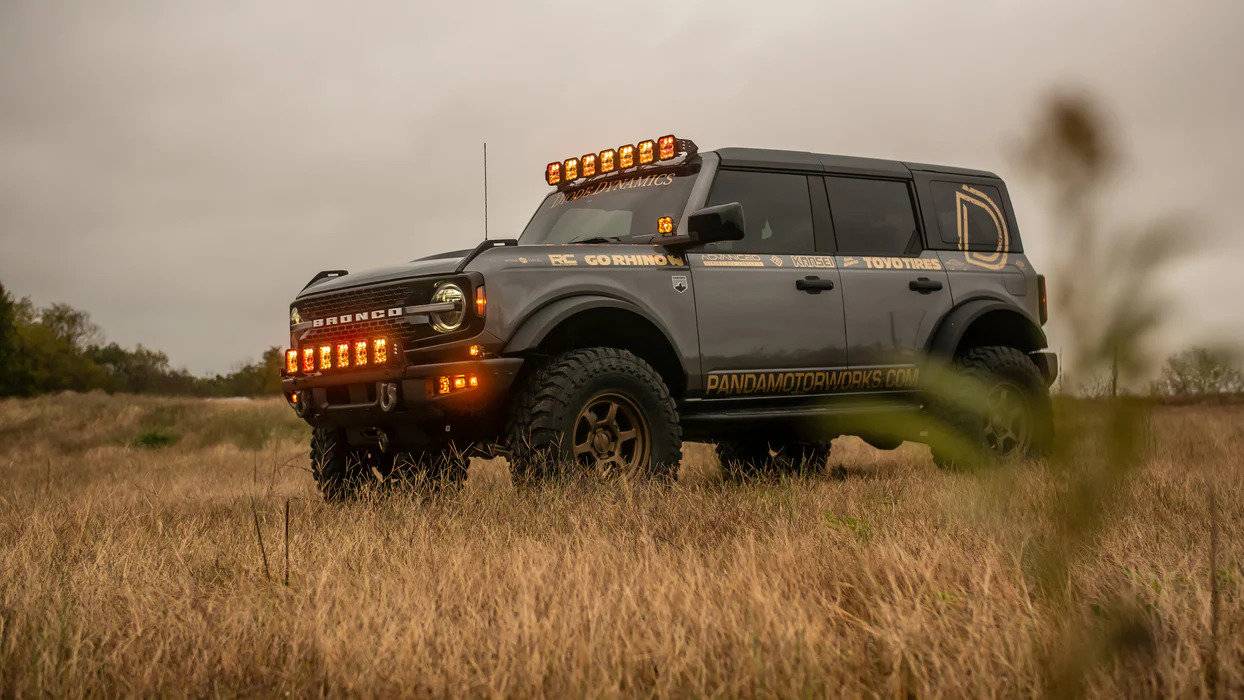

    anyone backlight their aux? Like DD
    for a running amber
    could probably be done with drill hole, 360 low power LED for cheap IMG_5305.jpg
