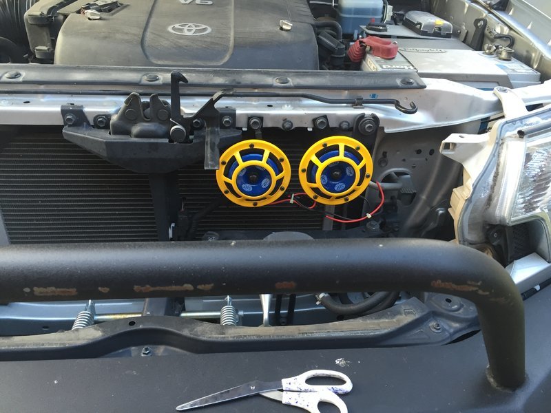

    I just went through this with a set of Hella Sharptones, and could not find an easy no-drill way to add a second set of horns. I put them in the location of the factory horns. You could move the factory horns to the two existing holes on the driver's side fender and extend the wires, but I wasn't able to do that, since I have my aux fuse panel located there.
