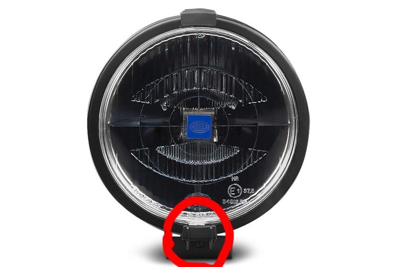

    Should be right on the front. Hold on I'll look up the black magics

    You're right.....looking at one of my pics I do see that little screw on the front right at the bottom! I'll be sure to check the bulbs if the relay ends up being ok.

    So this should be a screw you unscrew and that black square flap opens and allows the light glass to fall out.tmp_2842-2015-06-26_10.42.34-583911532.jpg

    Yup....that's what I see....thanks! Now if it is the bulbs, can I replace with any similar 55w halogen? If they are bad, I should have Hella replace as they're only a couple months old.
