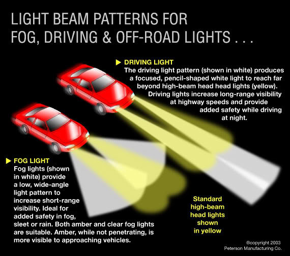

    what the driving light beam pattern like?
    is it wider and longer then hi beams?
  5. Apr 3, 2009 at 4:35 PM
    SocalMan22
    SocalMan22 Well-Known Member
    Mar 25, 2007
    #1146
    8,128
    Steve-0
    So*Cal
    06 PreRunner Dbl Cab
    What Mods!
    To me high beams send a wide pattern out, im sure its a driving pattern unless it states its a pencil beam pattern,
    pencil beam is just that - a very long, narrow beam - very specialized. Used for rally in conjunction with other lamps and used for desert racing but with at least a dozen on a vehicle
    fog pattern is very wide and very flat. Maybe 170 Degrees wide and only a couple feet high. Only good for several hundred feet by design
    Driving light produces a long-range pencil-shaped light pattern. Greatly increases night time visibility at highway speeds.

    it is a driving light beam pattern
    so is it similar to a hi beam pattern?

    An example
