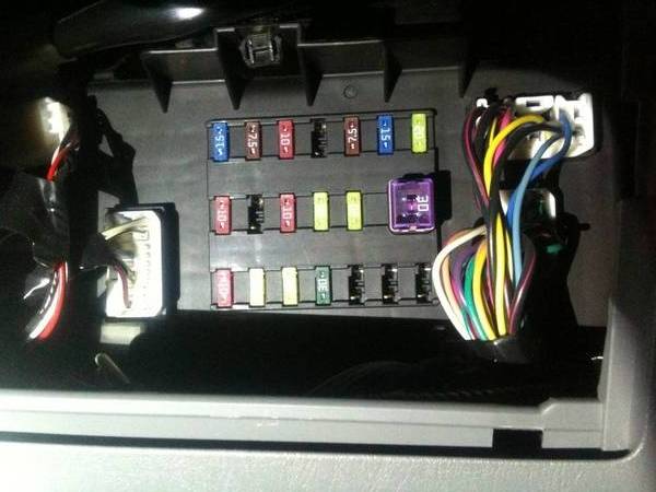

    Let me know if it works, I just went and took pictures of the fuse box and was gonna draw on it to show which one you should be able to use. let me know if you need it.

    Yeah that would be cool! I know two over and two down is a "hot with ignition" slot, but I don't know about any others.

    Here are those pictures for piece of mind. once you get some new fuses, let us know how it goes..
    Fuse Box:
    Fuse Box Label:
    SORRY THEIR UPSIDE DOWN... COULDNT FLIP EM'...

    So the ACC is the accessory? The brown 7.5a one? I was trying the one to the right of the IG1 NO.2, the blank one.

    Yeah I would think 7.5 wouldn't be enough... I may switch it out for a 15 if I try that option. Otherwise just use the add a fuse.

    Ill just throw them in with the 7.5 then haha. Ill go try it right now and see how it works.

    Yep problem solved. I actually pulled out the ACC fuse, replaced it with my fuse tap, and popped in two 10a fuses. Now they work perfect.
