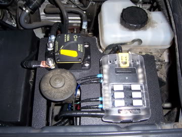

    Yeah on Amazon the one I want was about 40 bucks. In town at the boat shop.... about 68 :eek:
    So I need..
    -Blue Sea 12 Pole Fuse Block
    -100a(?) breaker
    -AWG 4 wire w/ connectors
    -Mounting platform of some sort....
    That right?

    Yeah thats what I had for mine. The 100A is what I have and what I've seen other guys with. Works great! Go buy some jumper cables for wire, itll be cheaper! all youll need is connectors. The mounting bracket I have was custom fabbed by a buddy of mine. Here is how it looks!

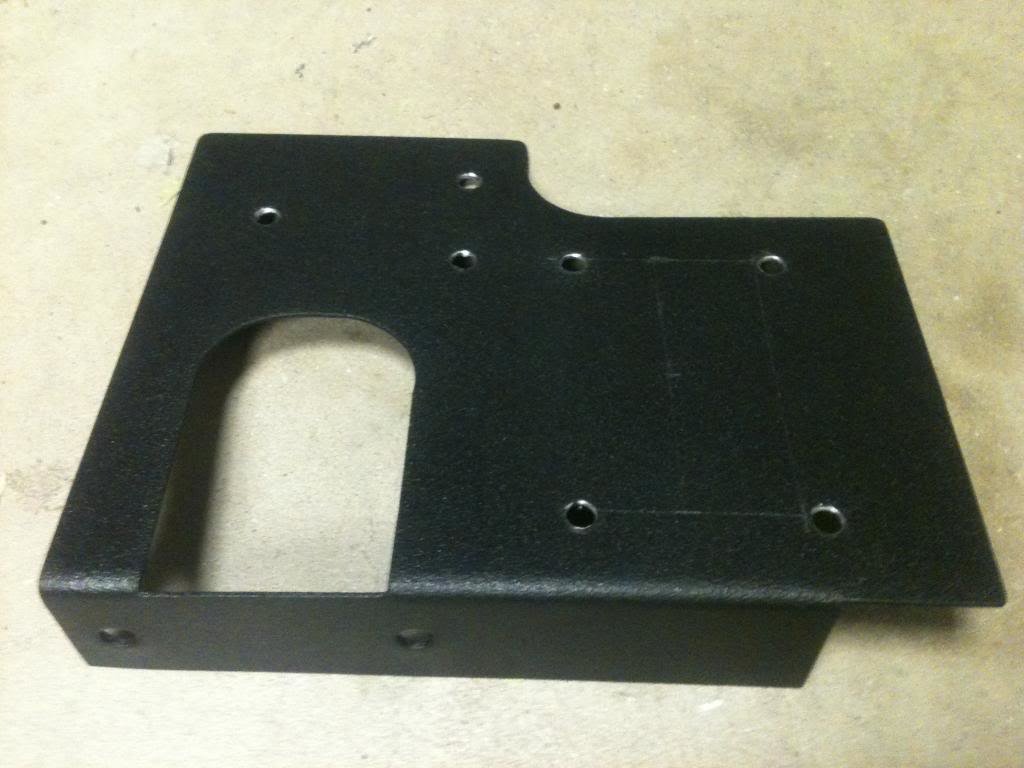

    I have a shop at school to work with, as well as a plasmacam setup. So the mounting plate would be super simple. Now I just need to save some money for everything else.
    I saw one thread where someone made a mounting plate out of a piece of lexan (similar to plexi). I have a dremel so that could be a good option as well.
