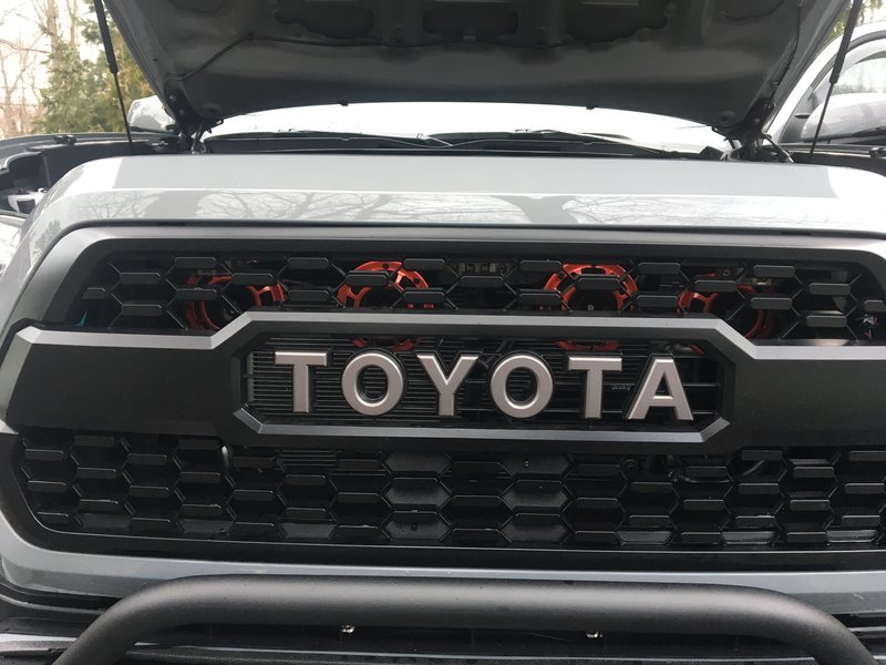

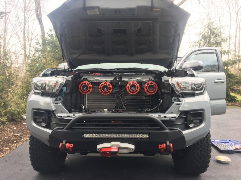

    Still waiting for it
    Thanks to @mesojdm for the harness.
    HONK!!!
