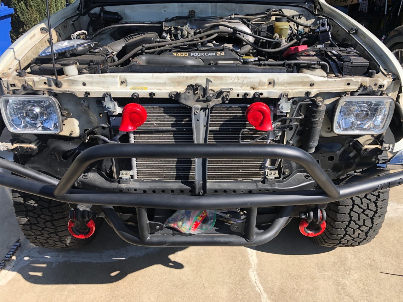

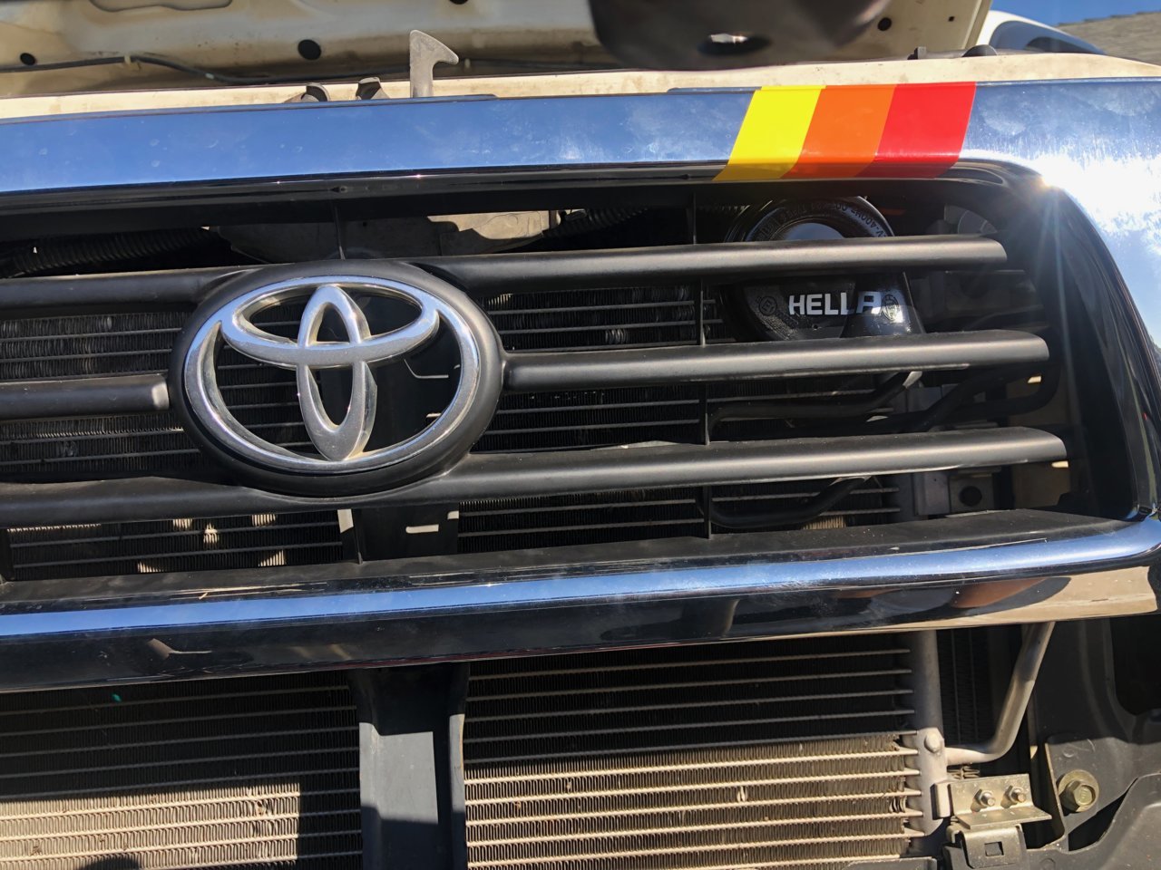

    The horn on the truck is worse than my prius. Supertones sounded like oem but louder so I opted for Hella Trumpets for the lower tone. Much better. An air horn might be more fun but for now this was a good $25 upgrade.
    I thought the red under the grill would look cool but its too obvious so I sprayed them black

    Did u use the stock wire harnesses for the new horns?

    From what I remember it’s just a 12v wire. You can extend that wire to the hella relay, add the ground and connect the horns. It’s really simple

    Out of curiosity, why the need for a new relay? I’d have thought the stock horns already ran through one. Is the draw of these much different than stock?

    I’m not sure. I think I just followed the diagram but it’s been a while

    Thanks for replying. Suppose it’s easy enough to figure out if I decide to make the swap. The stock horns are pretty anemic, but I’ve had them so long I’ll probably consider the swap only when I have need to pull the grill for another project. Missed an opportunity with a recent timing belt change.

    Maybe depending on the year Tacoma, the early Tacoma like mine has one horn and the 2000 forwards has two horns ,
    So possibly a relay is needed for the single horn going to a double horn setup?
