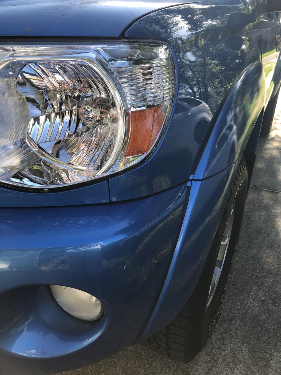

    All right got the new headlights in and just gotta get roof and hood painted. Leveling out my Tacoma is still an issue.
