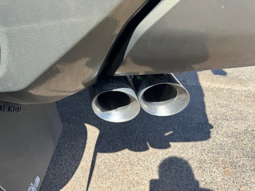

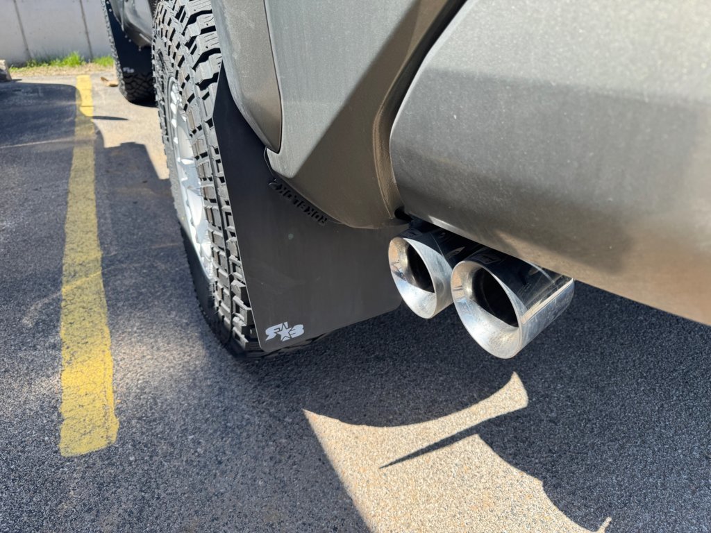

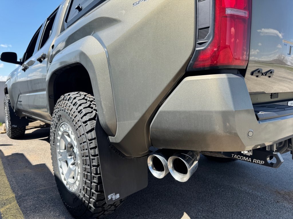

    First, before we had left for SAVE i put on a R4T high clearance exhaust. it sounded good, but with the topper, the resonance in the cab was too much and had to take it off. switched it up to a AWE exhaust with the chrome tips and am much happier. i will get some sound clips soon.
    After having the exhaust dump underneath and the resonance, i chose this one since it was a more traditional style.

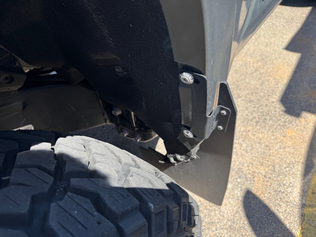

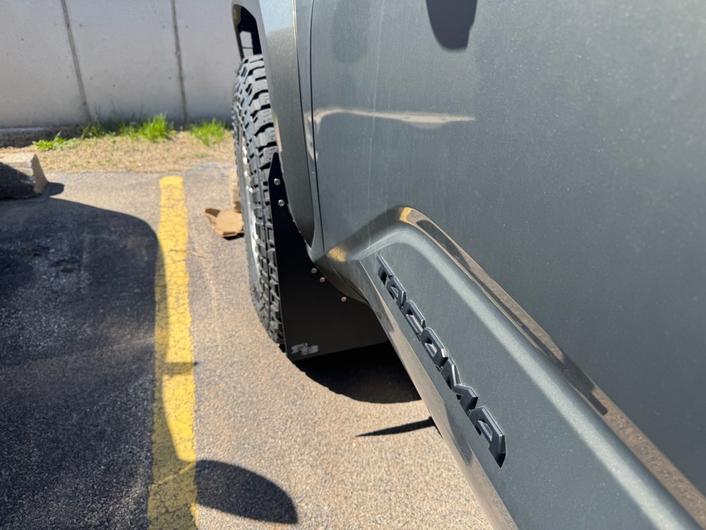

    also took the useless factory mud guards off and went with Rokblokz high clearance guards. Allowed me to take the crash bars off behind the front wheels as well.
    My tires were starting to catch the carpet style liner piece on the crash bar so i took everything off. much more room for activities in the rear of the fender well now.

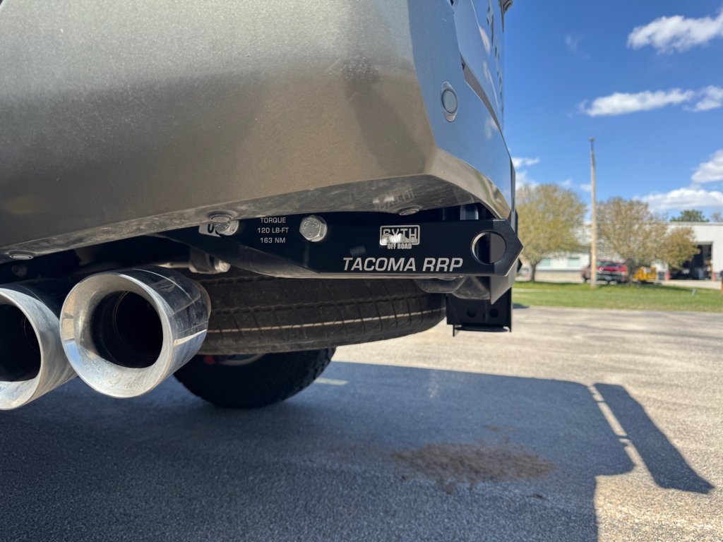

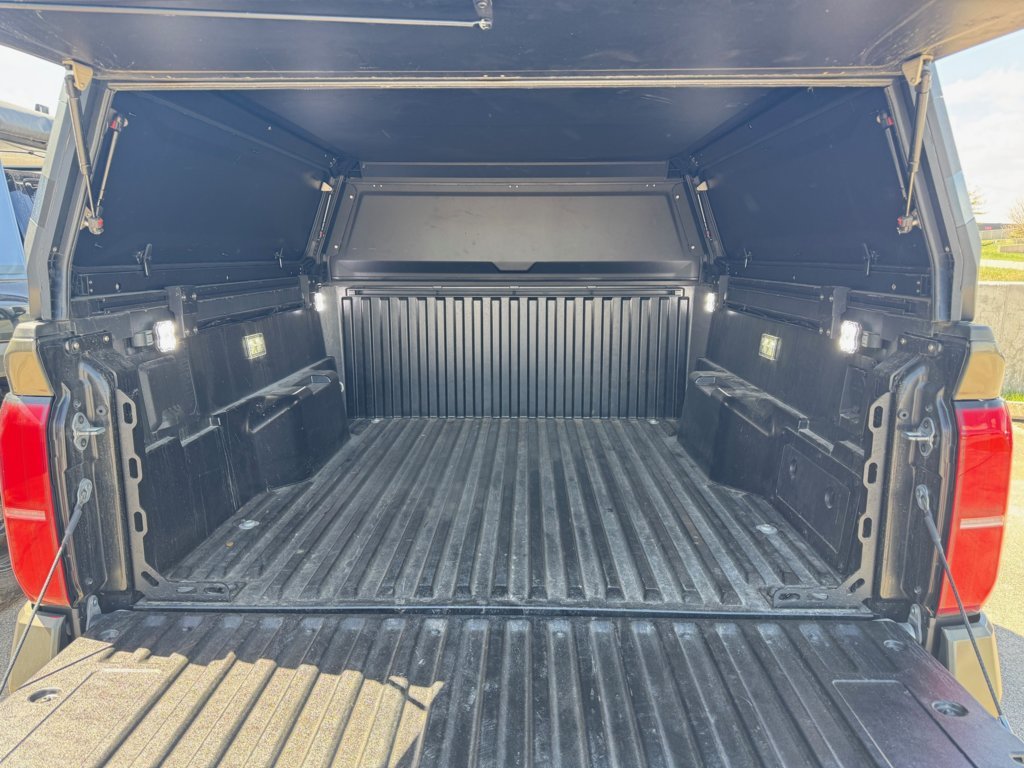

    and then yesterday added some products from Sxth Element. Had their ditch light brackets on the truck paired with Diode Dynamics SS3 lights and their bed light kit.
    also installed some BTF Fabrication bolt in bed stiffeners as well to keep everything upright and where stuff needs to be.

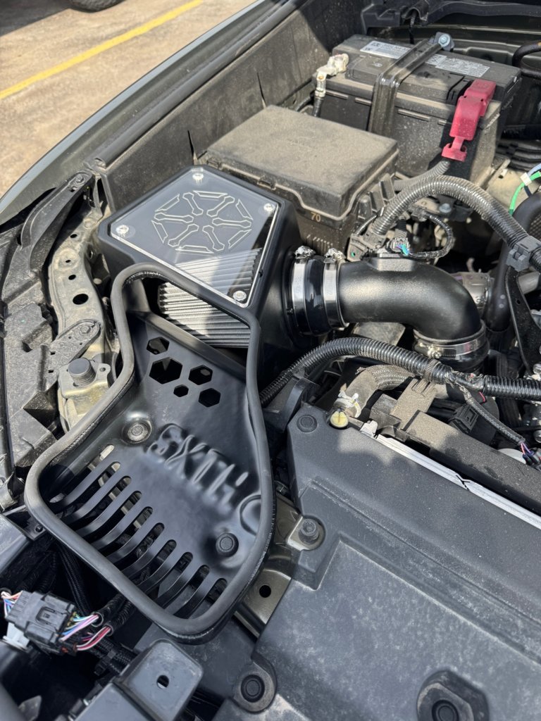

    Sxth Element's rear recovery points and intake are super nice pieces. The intake gave the truck the turbo noises i was looking for. my inner ricer is very happy lol.
    Recovery points are solid chunks of billet.

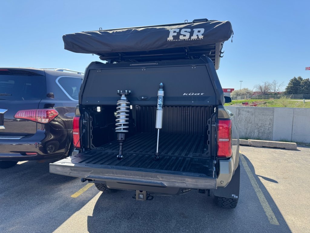

    The new Fox 2.5 IFP shocks arrived today, we will be installing them tomorrow. Excited to see how the ride quality of these are. fox.jpg

    we actually installed fox on one side and left the Billy's on the other with the ADO springs. Rear ride quality is hard to feel a difference but the Fox on the front is smoother over wash board and lower speed big bumps. The Fox also gave the truck roughly an inch more travel front and rear.
    i will get some pictures while i install the drivers side here in a bit.

    Nice…. Is that an adjustable preload collar on the fronts? Would be nice to dial in the lift 1-3”.

    Fox website shows a max of 2in lift, which is a shame.

    They came out of the box and i had 2.25" of lift. We turned the preload down to 1/4" and i still had 1.5" of lift in the front, which was the height i was looking for. the truck looked awful being completely level at the 2.25" setting. I now have 1/2" of rake at the 1.5" lift and im happy with it.
    Ride quality is similar to the factory bilsteins and ADO springs, but rough roads and washboards are much more compliant with the Fox shocks

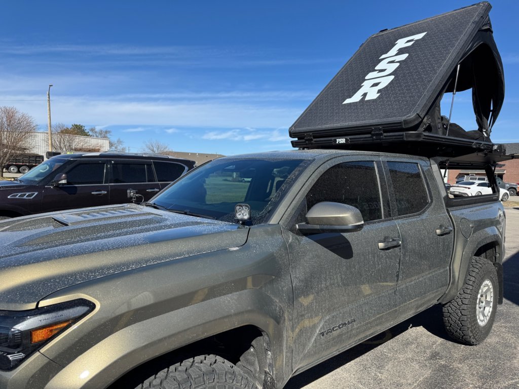

    First time I've actually seen that Kuat Ibex rack/shell mounted to a truck. Looks pretty nice, and I like the way they put the roof below the racks for mounting a tent. Too bad that they seem to have done away with plans to make the shell components for the mid-height rack.

    there was never talks of Kuat making a panel kit for mid height racks.

    I could've sworn they had it listed as "coming soon" a couple years ago. Not that it matters anyway, since it's not a thing.
