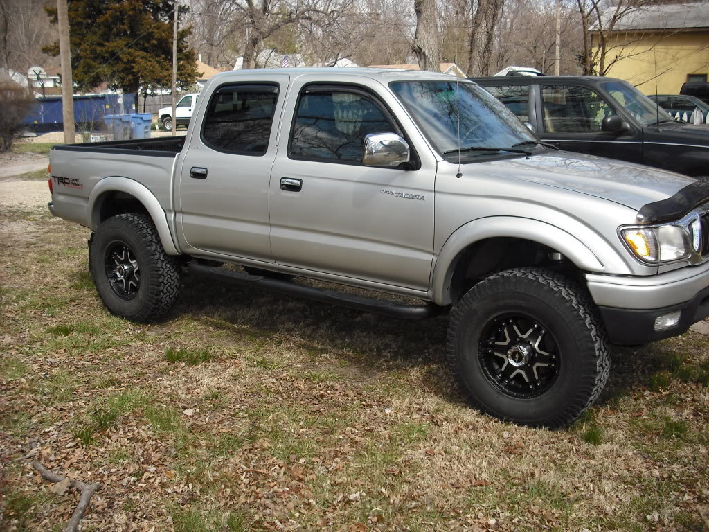

    I've got 285/75-16 BFG ATs on my DoubleCab on American Racing Tactic wheels. I do have the ToyTech 3" lift on it though. The tires rubbed the frame with my factory rims, but fit just fine after the new AR rims. You should check out the lifts, they are pretty cheap and easy to do. 265s should be stock size on your Taco. I got my rims at wheelsforless.com They have a pretty good selection at great prices. I paid $115 a piece for the rims that came with free lugs, stems, caps, and shipping.
