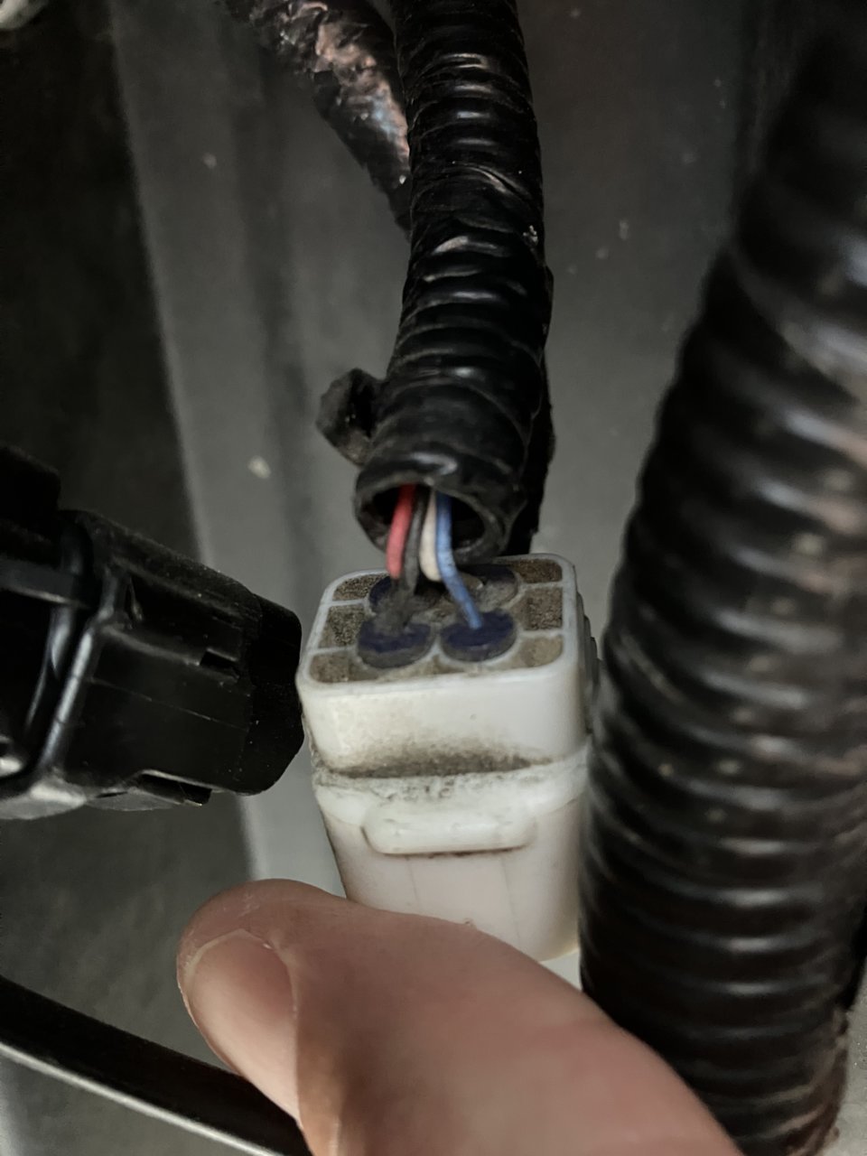

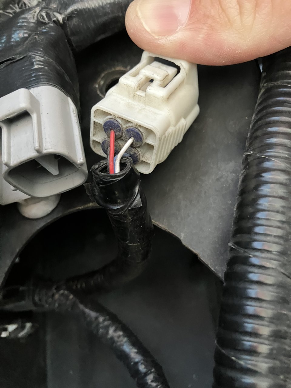

    Ok I took a look and on the branch out wire that connects to the back up camera it’s 4 wires White silver black and red. And on the camera connection is red black white blue

    I took this picture a minute ago

    Cool, 4 wire pigtail male and female at 6” with white black red and grey for silver. Let me build then I’ll hit you with a DM for the address.

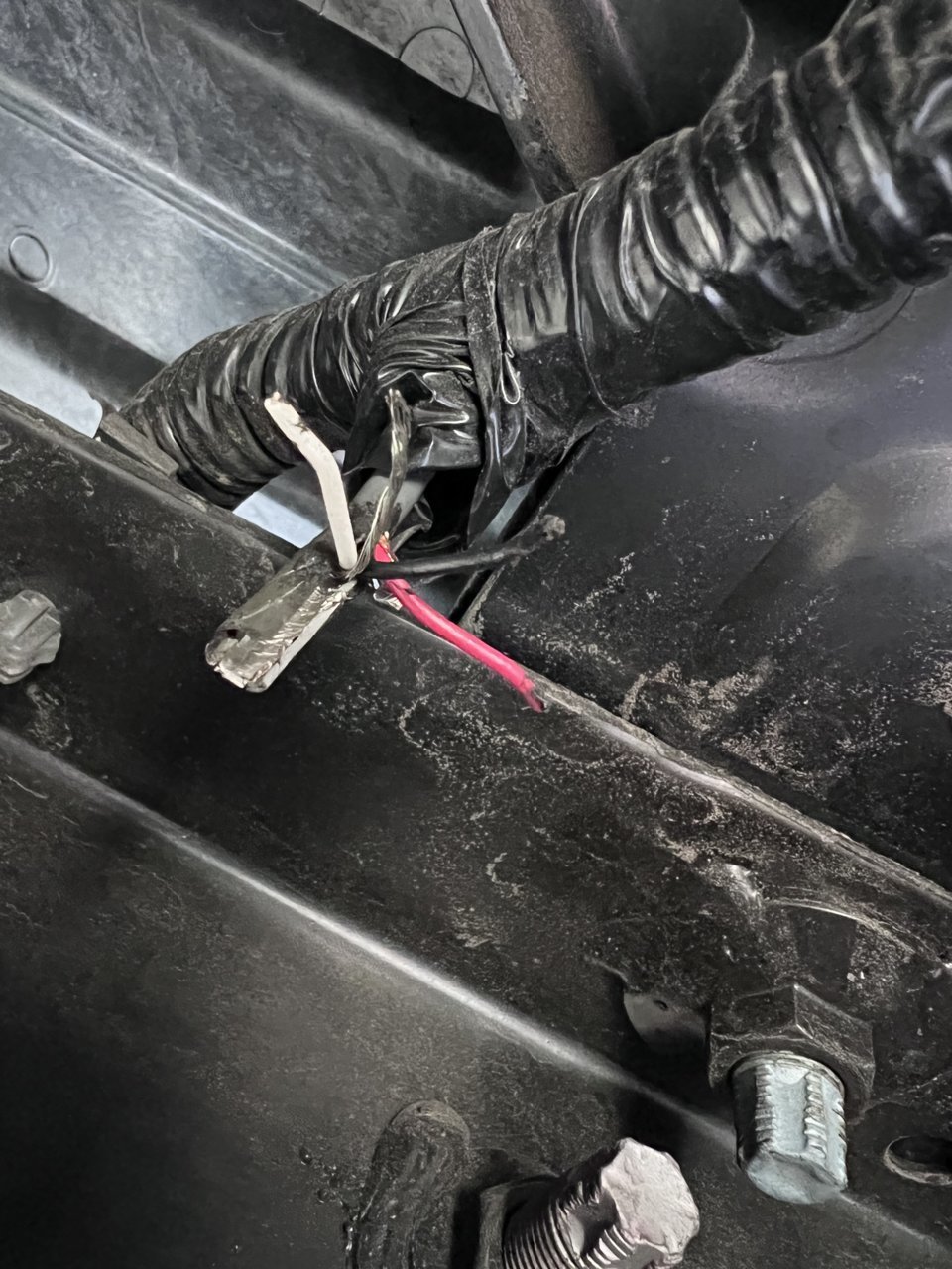

    I am not sure where they cut your wires but this worked for me. At least they did not get the tailgate. Hope you get it sorted out.

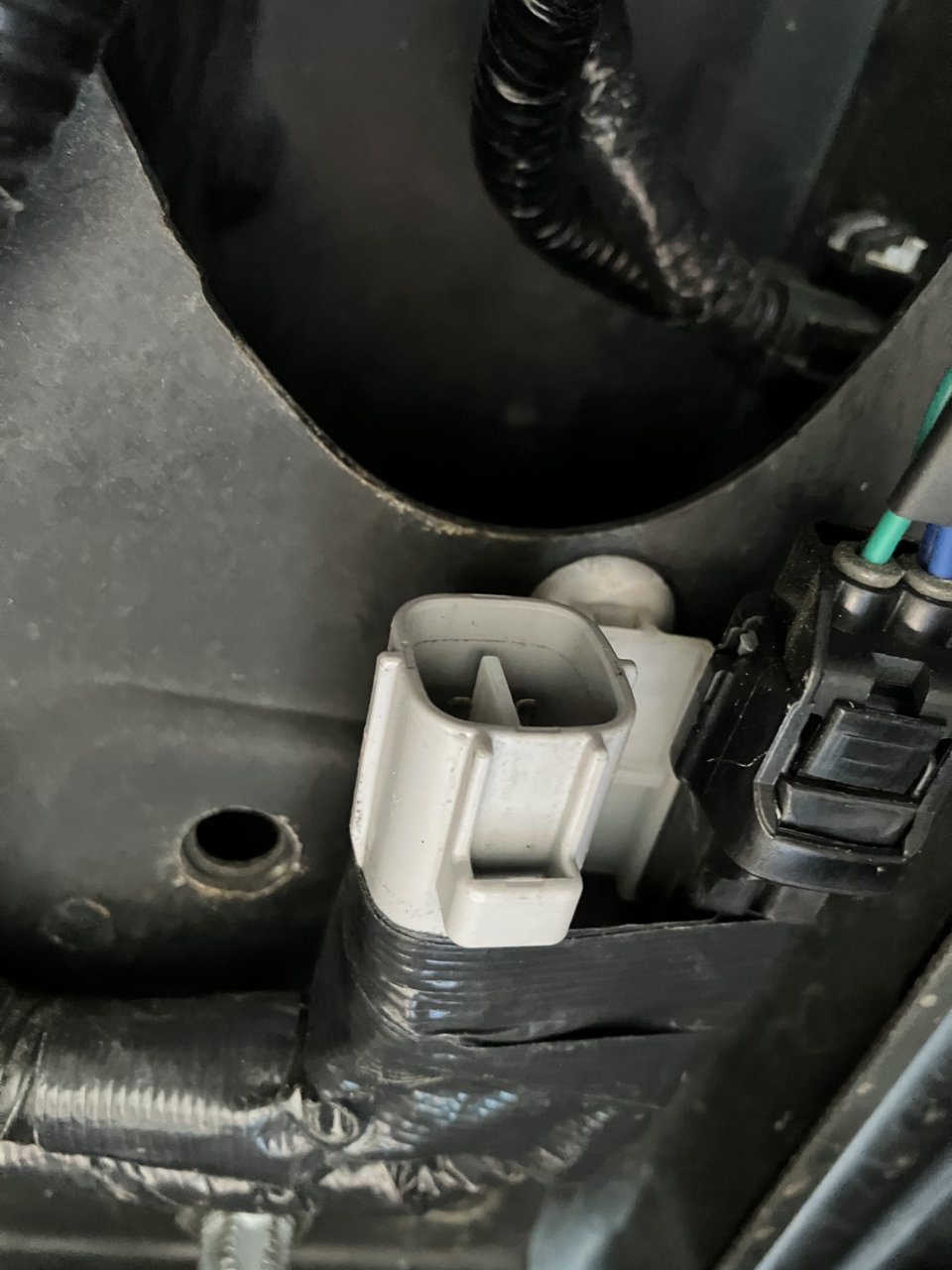

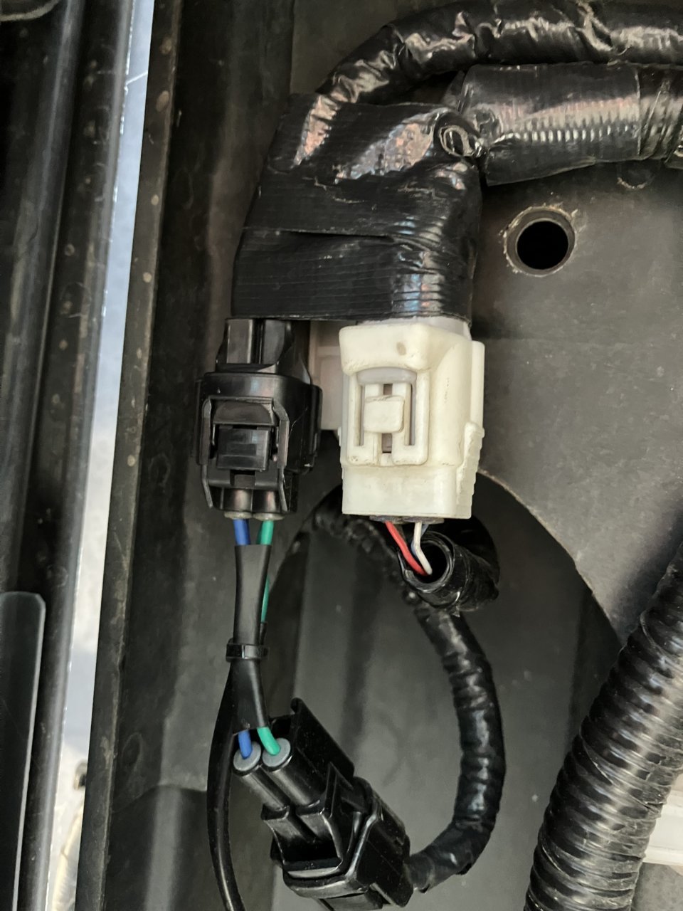

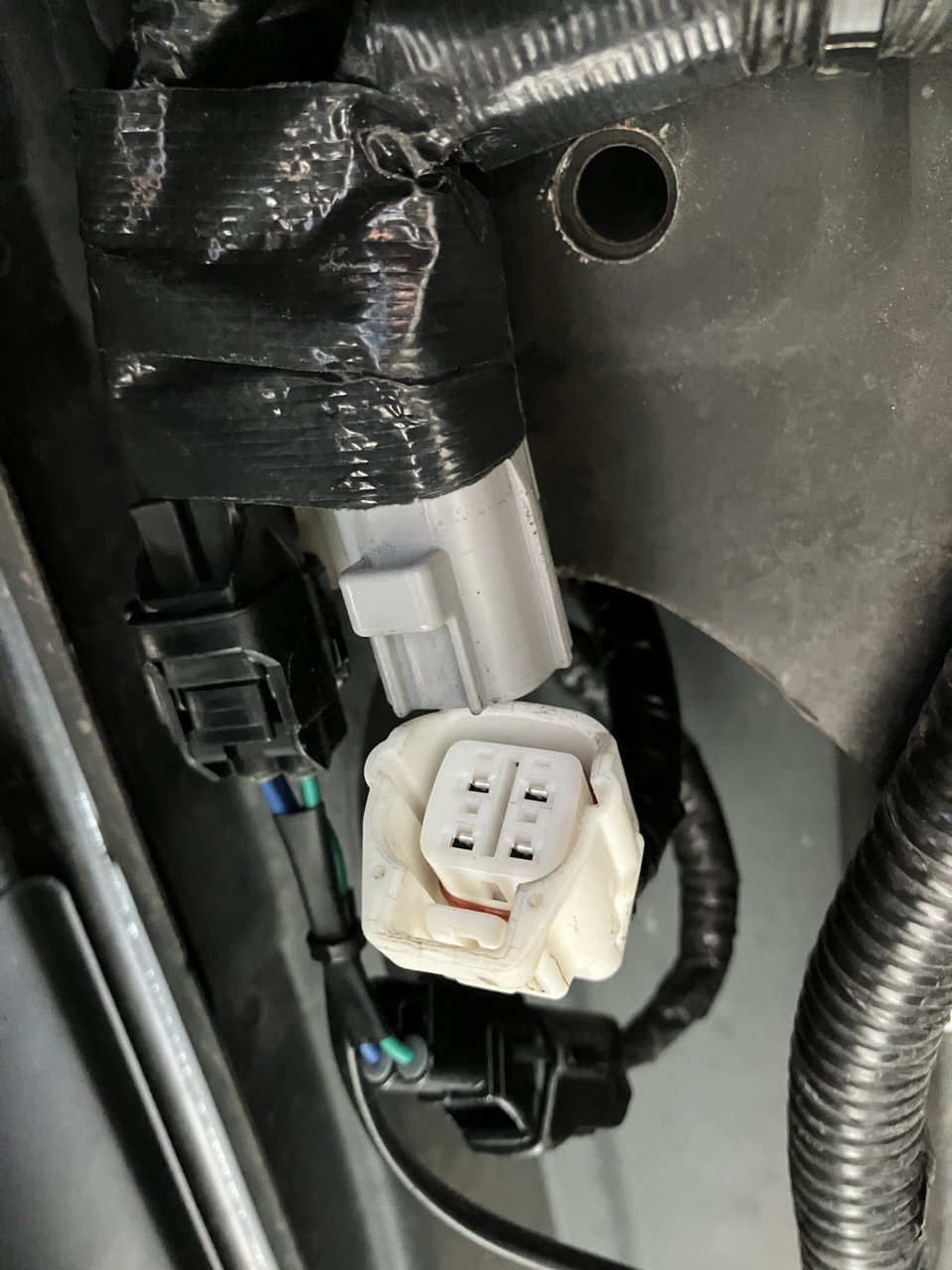

    Actually I think the connectors I plan to use are an exact match. Just OEM is white and mine will be grey both sides. Here is how my truck looks. I suspect yours is the same since you said blue. I’ll use blue then instead of silver.

    I’m definitely gonna buy a new OEM camera Harness. The main worry is trying to connected it to the main wire
    yeah that’s looks exactly like mine.
