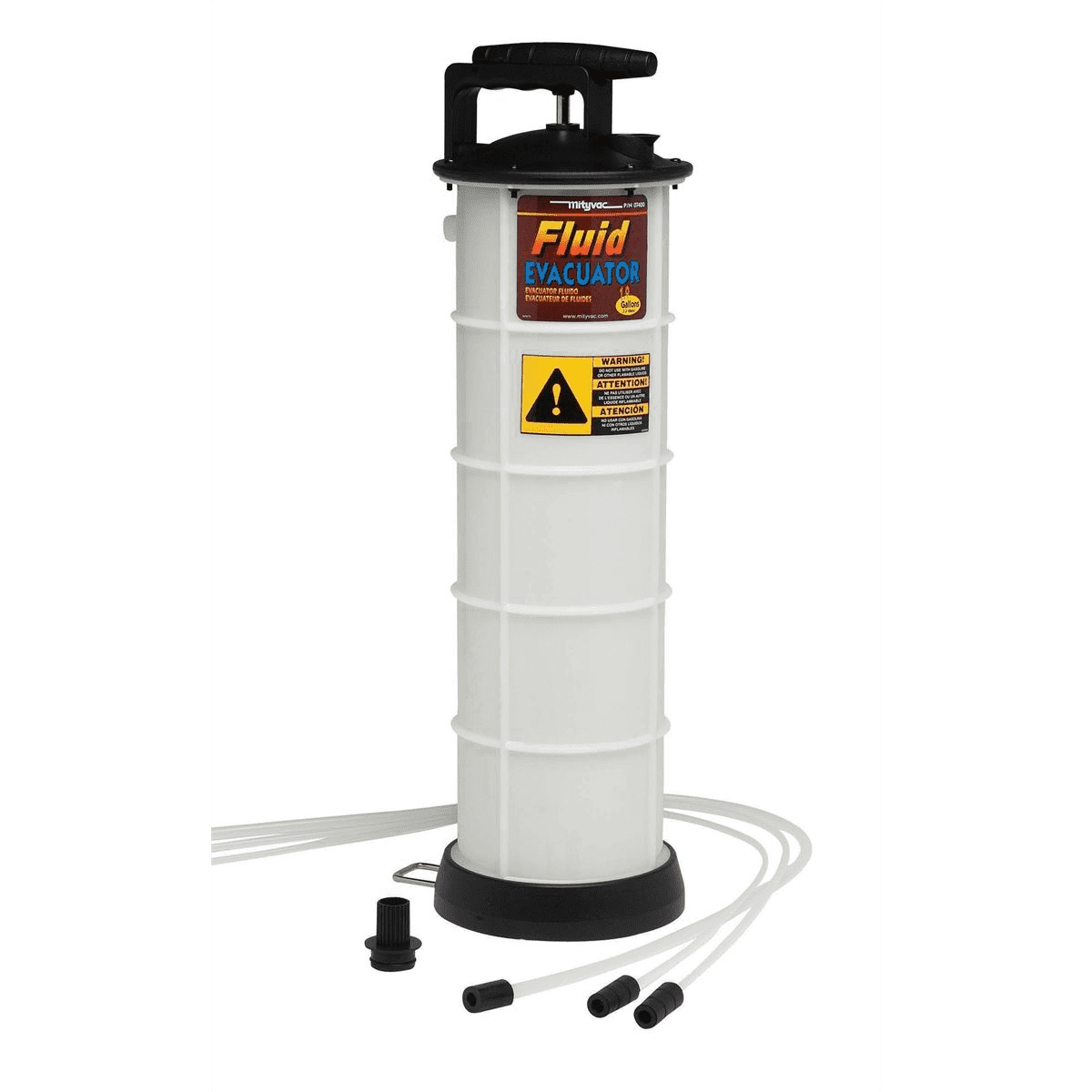

    When you're serious about siphoning brake/power steering fluid/etc.
