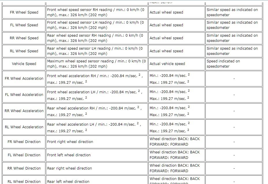

    If you have a scanner that can access ABS Data you can see what the sensors are doing.
